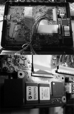

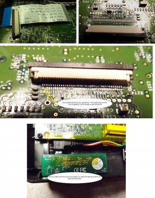

Today I got the "flipped" 15cm ZIF cable. Works great. The SSD ZIF drive now sits over the wireless stick and doesn't put pressure on the LCD.
I am guessing my ZIF connectors are different and that is the reason that I have to utilize a "flipped ZIF". I do install it with the contact face up rather than face down.

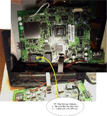

Ok. There it is again. 'Hot-swap'. Pete_c has mentioned this too so now I'm curious - which very very bad.

It is a flash chip located on the Joggler motherboard. I attached a picture to indicate where it is.
Carefully pulling apart the Joggler and turning it on; you can remove the EFI chip in vivo (hot swapping chip while Joggler is on); replace it with another chip and flash the 2nd chip. It is much simplier than it sounds and I myself was worried that I would cause more harm than good hot swapping my EFI chip.
I am not sure how many read writes the original chip has and it could maybe fix issues with a kaput joggler.

Ohhh. Thanks for clearing that up Pete - now I get it!pete_c wrote:It is a flash chip located on the Joggler motherboard. I attached a picture to indicate where it is.

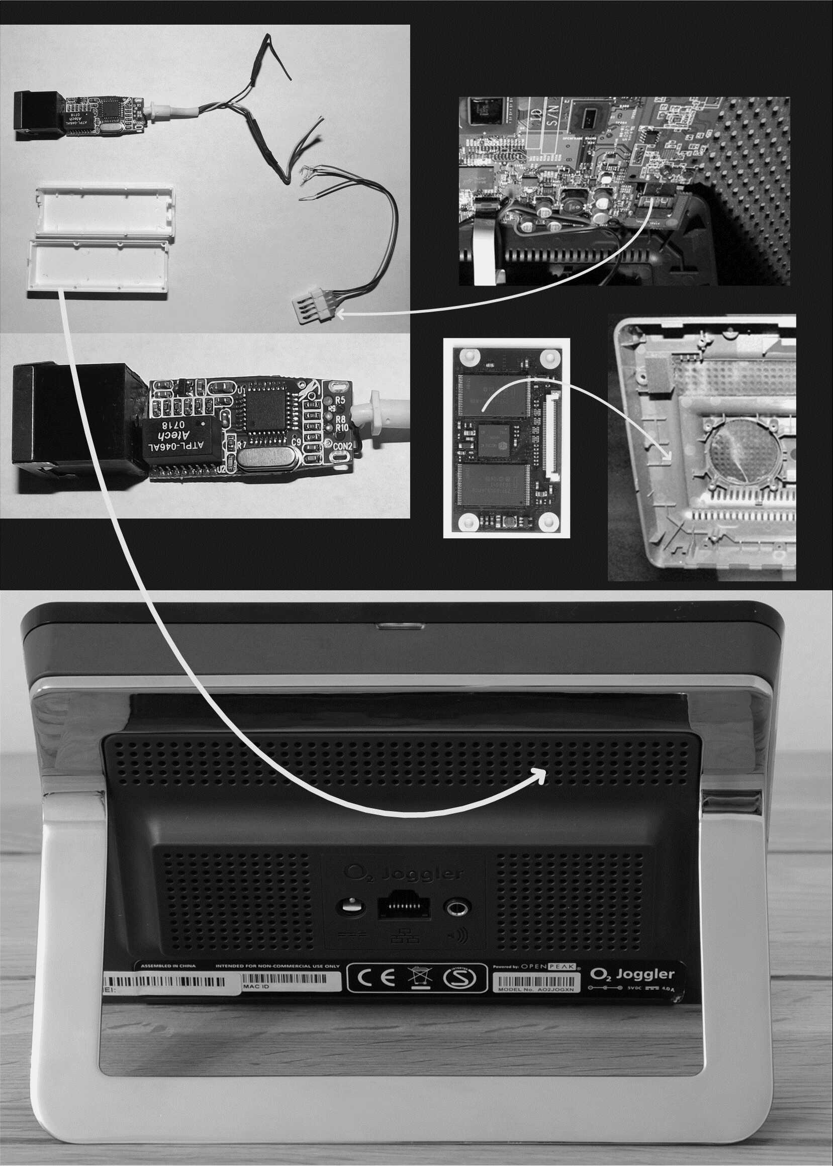

Just for info, it's really no big deal - see excellent video which shows you how at http://www.youtube.com/watch?v=KjMLUIoYQm4ilovemyjoggler wrote: btw I'm really not sure I could ever summon enough courage to take a joggler apart but this is really good to know - just in case disaster strikes!
Inside you will quickly find the wireless card is attached to the board by a standard usb socket.
Pull the wireless card up and it comes out easily leaving the spare usb available for you to insert a memory stick, etc.
That's what I did with my SqPOS/LMS Joggler, thus doing away with Joggler internal memory fickleness completely.
(Incidentally the wireless antenae come off the case easily by careful picking with a screwdriver. So there's no need to disconnect them from the wireless card as shown in the video)

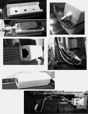

Making a second production (for use) makeshift Joggler using "Coreboot and Seabios" and an extended ZIF SSD pata drive.
This one will be using a small footprint (apple style) USB to NIC interface sticking out back of the Joggler using the internal USB port or adding one inside to outside. Might be easier just to make a thin USB cable extending outside and fastening a small USB hub on the back of the Joggler. The USB wires are so thin that I can utilize the small "venting" holes on the top back of the Joggler case.
This said because the currently running testing with Seabios XP box is doing just fine running with XP and with an externally connected USB to NIC device.
I have now extended the POE network some such that its easy to switch from a conventional NIC to a POE NIC by just moving a couple of cables over to the POE switch. IE: where ever now there is a Joggler plugged into the network can go POE with it. (1-wire and no transformer)
I can remote this Joggler on the network and if the power goes off it will boot just fine into XP.
I am using a very small USB to NIC interface and historically I have glued it to the back of the Joggler. This time I may just use a couple of very small screws inside of the NIC part of the interface to fix it to the back of the Joggler using the aforementioned "vent" holes.
Here is a picture of the USB to NIC interface. Note this is a $1 cheapie USB to NIC converter. I couldn't find where I put the original cut end of the USB to NIC converter so made do with another connector. I was able to thread the 4 wires through one of the same holes adjacent to the USB to NIC device. Using my newly (but old stuff) set up soldering station, "extra hand clamps" helped a bunch to do this.
At some later date I could also repurpose the USB wires for use with a small USB hub mounted in the same place as the USB to NIC device.
Relating to the network and POE the smallest working POE to Joggler device was a TP-Link. I have been testing one outside in an IP camera housing and its been fine now for over 6 months. That said the Jogglers inside using these same POE voltage converter devices have been fine now for about 6 months also.

I purchased whatever was on sale and cheap 16Gb SSD drives as they are plentyful out there in internetlandia.
Think they were Ebay specials at around $20 USD each (but its been a while now). The R/W speeds are very much different with an SSD PATA drive than the USB stick (whether regular or SSD). I had switched over to USB SSD sticks a while ago and those were faster than regular USB sticks.
My issues though related to having to use a "flipped" ZIF cable which is one side is tinnned opposite the other side. The next issue is that the thin SSD drive / cable wasn't thin enough to sit against the Joggler motherboard without distorting the LCD screen. Thus purchased longer ZIF cables such that I could fit them in the space where the USB WLAN stick was; if fact you can put it on top of it if you want and it still doesn't press on the back of the LCD screen. I think its just the ZIF connector on the Joggler as the pictures I saw posted here showed a one sided ZIF cable. The one that I use also is the same type as plugs into the little ZIF to USB drive boards which I have three of now. There is a name for said type of cable. (FPC or FFC??)
You have to be careful with the ZIF connector; as if or when you force it the little clips can come out of the holder; while you are not really breaking it; its really a PITA to put back into place. (an analogy would be the little clips that hold your wristwatch bands in place - if the come out of place; they are a real PITA to put back into place). That and I found out there is a color schema of thickness of the ends of the ZIF connector; where a blue end is "thicker" than a white end which is "thinner". A white end with an improperly utilize ZIF connector will just fall out as it doesn't grip properly.
Moving from using the Kitchen table to a regular little workshop table helped me a great deal. I have two connected lamps on the workbench. One has a large magnifying glass on it which works well with my old eyes. The other piece was setting up my "helpful" hands clamps and leaving the soldering station in place instead of moving it temporarily to the kitchen table. IE: I had a "favorite" motherboard which had the "exploding" caps syndrome. Well it was only three of the capacitors mounted on the motherboard. Easy to replace on the workbench; but very difficult to replace on the kitchen table. Fixed it though in about 15 minutes and now motherboard is working fine.
Now testing the newest Joggler "in production". With the "feature" of being able to upgrade the BIOS (even going back to the original Joggler EFI boot) is easy; and leaving the SSD drive inside will not hurt anything. That said now I do not have to open up the Jogglers to do anything to them. I tested this out yesterday by write an image within the running OS from one partition to another without having to remove the SSD drive. This makes it easier than say taking a USB stick and writing an image to it on another computer then booting up with said image on the Joggler.
Attached is the final piece. Note that I wrap the SSD drive in a non static plastic before closing the Joggler case. (whoa; what is happening; tons of spam this morning on the forum).

Today soldering a PATA ZIF connector on Joggler #4.
This said PATA ZIF connector is part of a batch of new ones that I purchased.
Looks to be well constructed but you have to kind of take it apart such that you can solder the two side pads to the Joggler Motherboard.
I will take pictures of said endeavor.
For whatever reason I cannot boot off of the PATA port with this connector and ZIF. I have double checked my connections and they are fine.
Now comparing this ZIF connection to a working ZIF connection. It appears that there is no 3.3VDC on pins 38 & 39 of the PATA connector; which is really a bit odd.
I am not sure why. Wondering if PATA traces are not connected?
That said the Joggler boots fine with the USB to ZIF device so installing that inside of the Joggler and hacking another USB connection for NIC interface.
I finished Joggler #4 with the coreboot/seabios configuration for "production" use. Similiar to the other two with a USB connected Asix Network interface. I fit a small USB to ZIF card under the ZIF SSD HD. This one is using a soldered USB port on the motherboard. Works great and boots almost as fast as the directly connected ZIF to PATA port Joggler.
