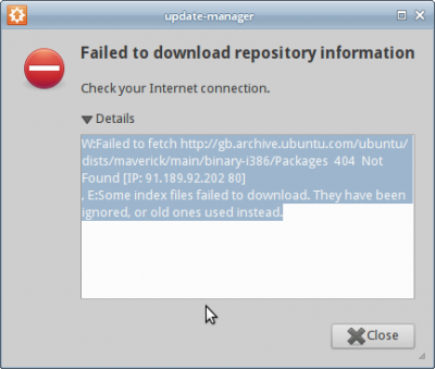

Hello people!
I'm using the Ubuntu 12.04 Base. When I try to update my sources with "apt-get update" I getting the fail: "Failed to fetch http://gb.archive.ubuntu.com/ubuntu/dis ... 6/Packages". Somebody can help-me to fix it? I need to fix it to install the lubuntu-desktop.
Thank you!
Thank you!
Re: Ubuntu / Xubuntu for the O2 Joggler.
the maverick packages have moved from main mirrors.
change the maverick line in /etc/apt/sources.list.d for maverick to
deb http://old-releases.ubuntu.com/ubuntu maverick main
Ooh, I'll need to push an update to sqpOS to fix that too. Thanks for the info!BuZz wrote:the maverick packages have moved from main mirrors.
When checking for updates, this error appears. Internet connection is not an issue as I can browse without any problems. Help greatly appreciated.
read a couple of posts up!
