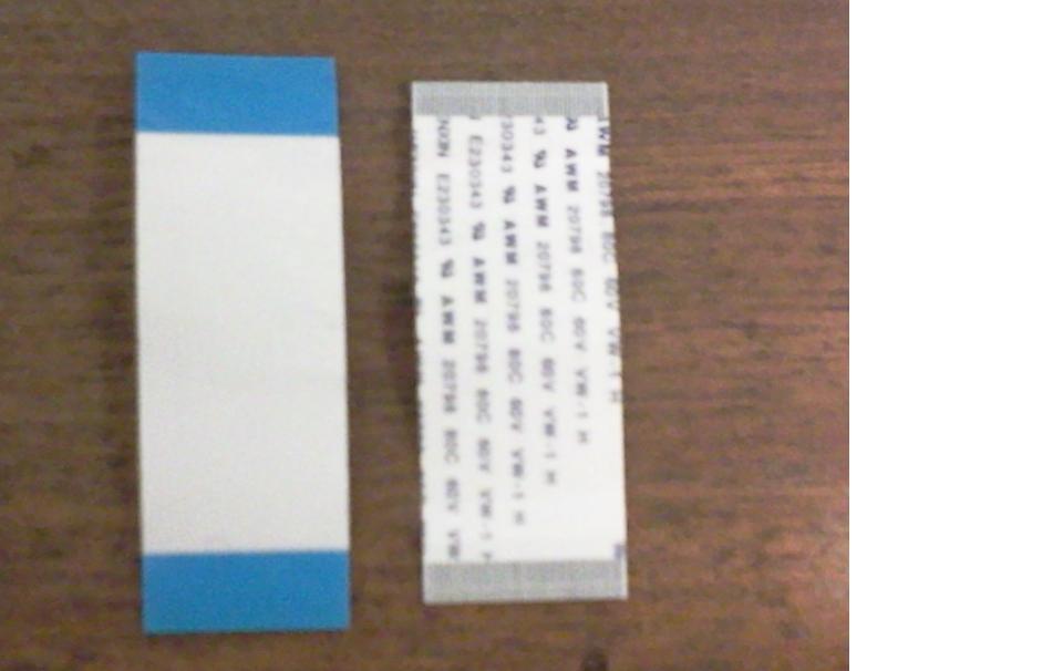

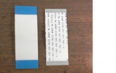

SSD ZIF Confusion
I received my newest ZIF SSD drive. I am confused though. What should the orientation of the ZIF cable be on the ZIF drive / motherboard?
The ZIF 1.8" hard drive works well with the ZIF to USB device connector and on the Joggler Motherboard.
I cannot get the ZIF SSD to work though.
Is it foil side looking at the connector on the ZIF SSD or down?

What type of ZIF cable are you using with the ZIF SSD drive?
Are you configuring your ZIF SSD drive en vivo connected to the Joggler?
I cannot see mine when I plug it into a ZIF to USB device. It might be the ZIF cable though. (ordered a few of these).
When I remove the ZIF 1.8 "Ipod" drive and replace it with the ZIF SSD it just freezes on initial boot.
Actually purchased the 16Gb SSD for $10 used and guessing that this one was also DOA. So purchased a new 16Gb SSD ZIF drive today.

pete_c wrote:mickchip
Sorry about the delay in replying, just got back off holiday.
I am using a blue both ends contacts on the same side zif cable

Thank you Mickchip
I was initially testing with a USB ZIF to SSD device. Today finally got the right combo ZIF cable / ZIF USB configuration. That said my working ZIF combo to USB device is using a "flipped" ZIF cable such that the tinning side is opposite normal ZIF cables (I have now all of the various types of ZIF cables known to exists). I have a few very small ZIF cables that should do the trick for the inside of the Joggler.
That said I have also been "collecting" various size SSD to ZIF drives for my collection of Jogglers.
I am mounting a new ZIF SSD drive inside of one Joggler today and putting the case back together such that I can remove the device from my workbench and leave it wherever in the house.
Today too I switched over to using the Digi powered USB hub. It works great. I just did a copy of the internal SSD to the external SSD via USB.
