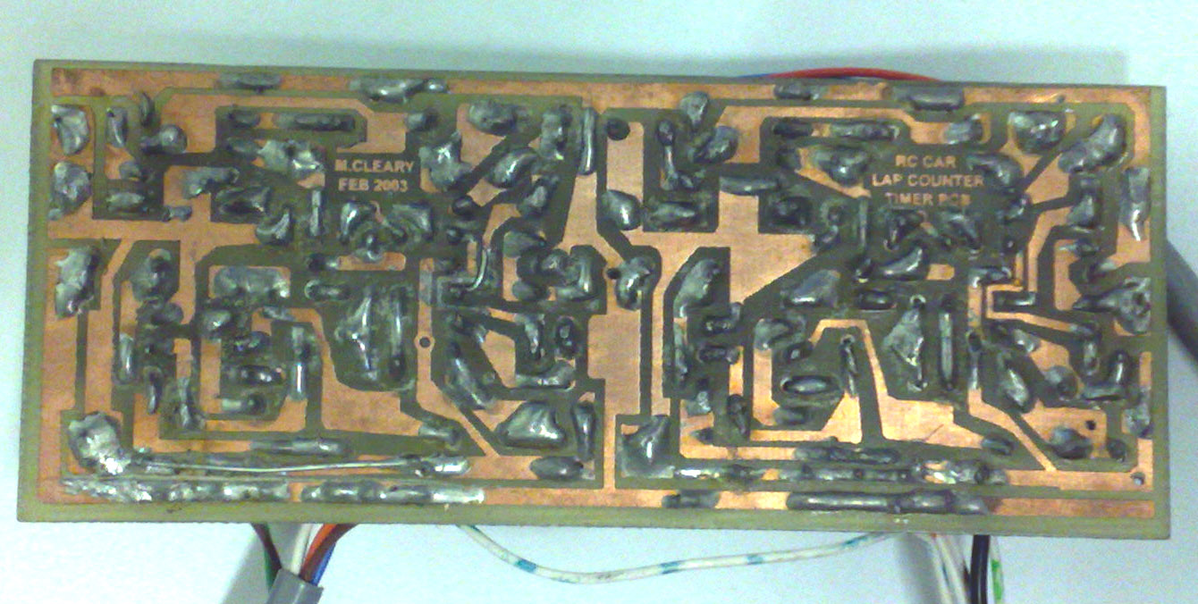

After seeing that board that you built reminded me of one I once built for my grand kids,
it was an infrared lap counter and timer for 4 mini rc cars (as you can see not quite up to your standard )

mickchip wrote:After seeing that board that you built reminded me of one I once built for my grand kids,
Maybe I should keep quiet about some of the larger and more complex boards I've built recently. That's pretty cool though, looks oldschool. I've made an awful lot of boards with my home chemical baths too but find that for the more complex stuff, it's better to design it, and pay someone else to make it :P

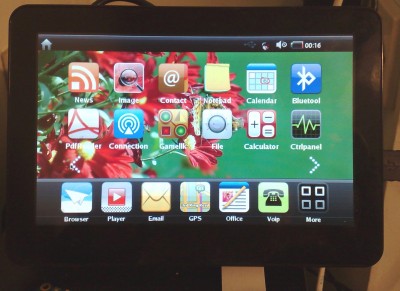

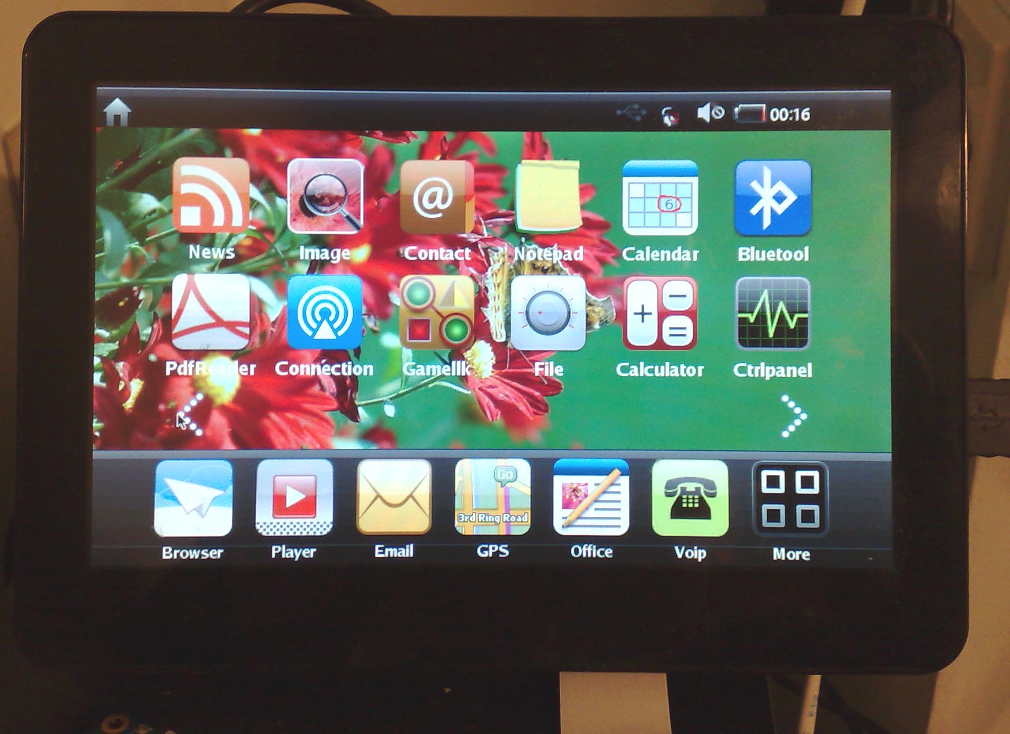

Been trying to get this to install with a GUI for ages, could install but only ended up in a terminal.
Well i've done it, nothing works as yet (touch, wifi,ethernet etc) but now I can work on that.
By the way, I can only get it to work off the pata port, won't boot off USB.
