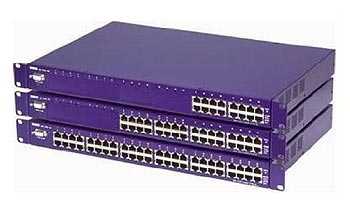

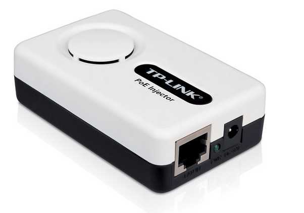

Here I have 4 Jogglers (Jogglers are literally all over the house today - WAF is good) connected to a standard Tycon POE switch injector with TP-Link power splitters providing the 5 VDC for the Jogglers.
I am now utilizing the Tycon 24 port mid span POE injector for IP cameras, Android and CE based in wall touchscreens in addition to the Jogglers.
They have been connected in this manner now for over one year and working well.
- Tycon Mid span POE Injector
- Joggler POE.jpg (9.71 KiB) Viewed 18927 times
