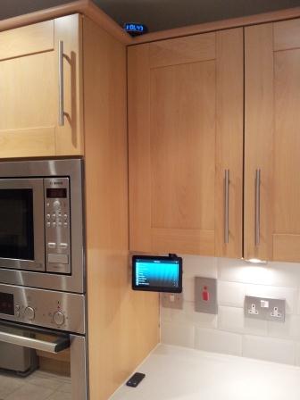

Admittedly a low tech solution but I've mounted one under a kitchen cupboard the right way up using a flexible arm satnav windscreen mount attached to the Jogglers metal stand.
The flexible arm also provides something to zip tie the cables to to neaten up the installation.
Works quite well and I'm pleased with appearance - see pic.
It's connected to an Ixos Divo sound system with sub and satellite speakers hidden on the tops of the cupboards.
This system has a separate iPod dock which houses the receiver for the remote control.
We don't have iPods so I've positioned the dock on the top of the cupboard and the bluish led display complements SqueezePlay so it looks as though the two come together.

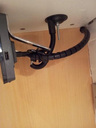

Here's what it looks like from behind - perhaps not the prettiest but it's all hidden by the screen from the front anyway.
1) Disassemble the suction part of the windscreen mount. These usually work with a centre pull to create the vacuum when you stick it on the windscreen. Disassembly leaves a nice hole through which to bolt the mount to the cupboard.
2) Use a coach bolt to attach to cupboard. These have a flat rounded head so won't snag your cornflake packets in the cupboard! Must admit I need to trim the bolt down now but left it long at the time because I was thinking might attach something else to hold the speakers remote control when not in use.
3) Remove claws mechanism that grips satnav from other end of mount. That revealed a flat plate with 4 holes in it that luckily matched up nicely with the flat width of the Joggler stand. So simply used cable ties to attach the two. This was at "proof of concept" stage (!) and did think would drill the stand and use nuts and bolts for this later but actually cable ties are fine so I've not bothered to change them.
4) Used a cable tidy from Maplins to trunk the power, ethernet and headphone wires into the space behind the cupboard and upwards to the location of the speaker system.
The whole thing is quite sturdy.
There is slight "give" in the satnav arm as you press the screen but it actually complements the touch screen action rather than hinders it.
Overall effect looks good I think (wife happy), frees up workspace and gets the Joggler away from cooking debris!!

harani
Posts: 9
Joined: Tue Jun 14, 2011 10:01 am
Re: upside down joggler
Post by harani »
Nice job
are you using the mount to actaulty hold the bar/stand rather than case of the unit itself ?
i've been looking for a sat nav type mount for mine and either they are not wide enough to hold the unit or obstruct the power/audio/USB ports
Fishy
Posts: 93
Joined: Wed Jun 27, 2012 4:46 pm
Location: Manchester, UK
Post by Fishy »
harani wrote:Nice job
Yes, the mount is attached to the bottom of the Joggler stand not the unit itself.
Thus the sockets are not obscured.
The satnav mount was a generic one with expanding claws to grip any satnav.
I removed the adjustable claw section from the satnav mount.
That left a flat plate with 4 holes in it.
Then zip tied that to the base of the Joggler stand.
It was a bit tricky because the mount arm had to almost double back on itself so the flat plate married up to the Joggler base - you can see the metal inner of the arm showing in the picture as the plastic outer slid back slightly bacause of the extreme angle.
However once done it's fine and as I said previously whole thing is sturdy enough to do the job well.
Thanks for compliments!! :oops:
