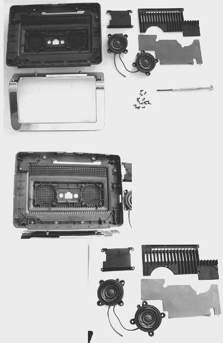

I decided to take my test Joggler with the 3rd USB port hack to the next level by redoing the back cover for the Joggler and maybe hanging it on a wall via the back cover and passively cooling the CPU by removing both or one of the speakers.
Here's the beginning of a pictorical take apart and redo.
First picture is the back cover taken apart.

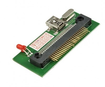

I started to play a bit with the mini ZIF/CF card USB boards found on Ebay. I can mount this little board / CF card and it utilizes little space. I switched over my Seagate Dockstar to using the CF card to run the OS and it seems a bit better over time versus a memory stick. I've lost one USB SSD card already. It might have been a QA thing though.

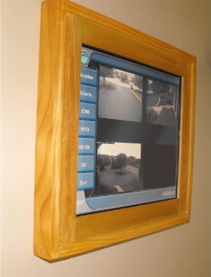

I purchased a 3M Microtouch capacitive 17" open frame LCD with a thin footprint a few days back.
http://solutions.3m.com/wps/portal/3M/e ... s/C1700SS/
The design of the open frame touch screen LCD allows me to install it on the wall and have a small opening for the video, power and serial touch connection. (that piece is only maybe 8"X8").
The installation pictured replaced a 12" resistive LCD I had mounted there and used for about 8 years or so.
Meanwhile installed a new 17" capacitive touch screen and made a wooden frame for it yesterday. It's being driven by an Aopen Digital Engine DE-945FX core duo PC.
http://usa.aopen.com/Platforms.aspx?id=78
Here are some pictures.
