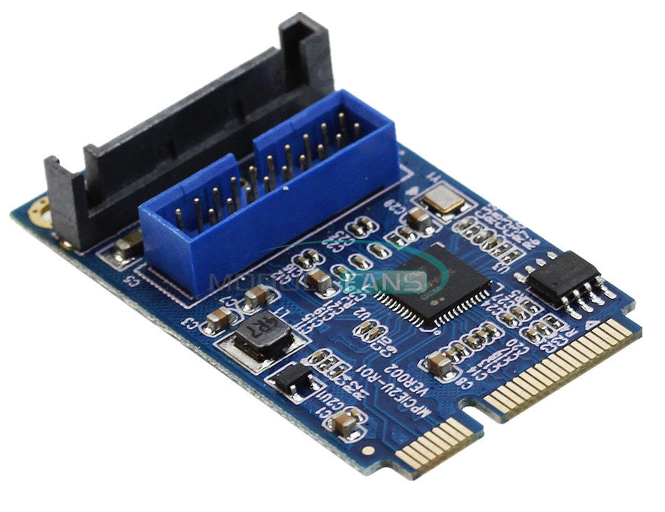

4 - repurpose the mini pcie card slot to maybe a mini sata to hard drive (SSD). The IDE ZIF pins are there for soldering on a ZIF clip.
The mini pcie cards (SATA) are a bit too tall but would work. Note tested an mSATA card not to work. 5 - Built in DECT and Zigbee chip
