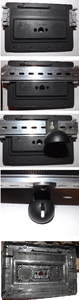

Here I still have the base of a Joggler (without anything else in it right now). I actually redid the support such that it would be stronger with three small machine screws. This is a bit of some hardware modification. That said though you could maybe purchase a "broken" Joggler and test using it as spare parts.
All in all though it would involve removing the metal stand which actually appears to serve a function as a heat sink but really doesn't. I noticed that in other OpenPeak devices the insides do have a metal heatsink and the Openframe 2 has a removable metal pivot stand.
I think its only 4 screws that hold the metal bracket in place. It is very well contructed. If you go really slow its not a major issue to remove the bracket.
That said I used 3 really tiny machine screws using the same holes behind one of the speakers such that the speakers would function as normal to support the little speaker pivot bracket. Using spare Joggler pieces you could build this little support structure on the back of one and transplant the insides of your working Joggler to this one back piece.
If you do not want to do major stuff; then you can simply remove the bracket and use tiny sheet metal screws with large washers to hold a pivotal bracket to the back of the Joggler using the little tiny holes (vent holes?) without actually causing any damage to the insides of the Joggler.

So far while testing "stuff" I have removed the bracket and run the Joggler for hours like this.
I will try some benchmarking to see if the temps change that much after days.

Re: Joggler/tablet cradle
Tested the speaker bracket thing yesterday and it will not work even with little support screws; it's a bit too much stress on the plastic case.
Trying something I have been able to replace the "stand" with something that might work better and am testing it some today. Will take some pictures today of what I am trying.

I've been "playing" a bit with DIN mounted LCD power supplies relating to my outdoor landscaping and had the DIN rails laying around. They are difficult to find in the US and I had ordered them from China. The prices are all over the place though and I purchased 6 in bulk with free shipping for less than $10 USD. The little plastic DIN mounts are about $3 each USD.
The DIN rail is made out of aluminum and is light but sturdy and easy to cut or drill into.
If you cut and mount the DIN rail on a wall it is almost a flush connection and is pretty sturdy. You can paint also such that its not shiny.
That said the plastic DIN mounts are currently utilized for my Aopen Digital Engine computers and one carpc and they fit perfectly as pictured. Using the Din rail you can fix or mount on wall as seen. If flush though you need to make space for the wires in the back. It seems a bit sturdier than the direct to back of mounting of the speaker bracket so far. Note that I am using the metal bracket holes for one of three screws that can be utilized for the DIN bracket.

Yup I didn't really notice until I added some weight. The speakers that I utilize with a similiar bracket are heavy and almost all metal.
The larger bolts though with the threaded holes in the speaker are much more sturdier though.
I am not at the weight testing piece of this endeavor.
The two little side DIN mount brackets are very tight and with two little screws connected to each bracket they will be tighter.
What will make this mount sturdy though is to have more of the mounting bracket attached to the wall. The Joggler will then snap into place.
Truely though I won't know until I play with it some more.

I test mounted the DIN rail thing with the small speaker mounting bracket. It is better as the support and is structurely more sound. To remove it though you can either go behind it and disconnect the speaker bracket with the one finger plastic topped screw or just unclip the DIN mount with two hands. The whole set up looks better just using the flush DIN mount though than the speaker pivot mount. The speaker pivot mount adds about 1.5" to the back of the Joggler but lets you tilt it up or down or sideways. If you mount this contraption on a wall with a one gang box you can have the wires going right into the box and still have the Joggler flush to the wall. This would essentially provide a small fooprint on the wall set up that is fixed though with a very small opening for just the wires. You really wouldn't need to frame it and you could paint the din rail any color you want to make it aesthetically pleasing.
The real test though relates to the WAF factor if said device is mounted inside of the bathroom and on a wall there. The infrastructure is now in place for this (network et al).
Today I cut the DIN rail such that it is the same width as the Joggler. As it is made of aluminum it was easy to cut.
I will also today mount the din plastic mounts with two screws instead of one per plastic DIN mount.
In addition will add another screw to the speaker pivotal mount. I did notice today that the pieces on this speaker mount that are structural are made out of metal which is good. Having it mounted using the speaker bracket allows for more space for the cabling behind the Joggler. Leaving the speaker pivot bracket on the back of the Joggler also adds the ability to remove it from the DIN mount and rest it on a tabletop as before with the metal Joggler table bracket. The angle of tablet view is almost identical.
I added two more screws such that the DIN brackets are held better. You can also put a couple of drops of some glue there to make these mounts even stronger.

This methodology involves a little bit of disassembly. You can just pull away the motherboard from the case without disconnecting it to remove the bracket screws thus becoming a bit less invasive. I have done this for hot swapping the flash chip.

My "contraption"; pictures above; is still attached to a "wall" in the basement. I never reinstall the Joggler motherboard to it; but that is the easy part.
My wife asked me what it was the other day.
It does involve taking apart the Joggler and fitting it with two DIN mounting brackets (which are plastic) and removing the tabletop bracket.
With the little speaker pivot mounted it also allows for some space for network and power connectivity. You can also paint the din rail some other color to make it more aesthetically pleasing to the eye.
Total cost of the hardware is less than $30 USD.
That said though the Joggler 2 is built differently. The back tabletop angled metal is still there.
Inside though it uses a metal plate which is literally the width of the motherboard which indeed does keep the Joggler 2 a bit cooler when running.
The Joggler 3 is even better for this sort of thing as the back bracket is removable and you can easily connect some sort of wall bracket to it easily enough.
