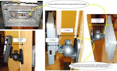

Someone asked recently on a different means of wall mounting a Joggler without cutting a large hole in a wall.
While the Joggler still is not flat on a wall; this pictorial allows for pivoting of the Joggler and is relatively low cost using a speaker style mounting bracket.
This may be my means for the installation of a Joggler in the master bathroom in this house. My intentions are to utilize a double sized gang box with one side holding the bracket a bit recessed and the other side using standard 3 insert jack wall plate (IE: network, power and speaker output).

Working now on a plastic dual gangbox box such that I could do a plug n play with the above. One side will be a sort of mounting bracket for the above and the other side will just have three keystone jack holes. These will be for:
1 - network
2 - power
3 - audio or USB port for USB to Audio device.
I also ran a new POE network cable to the bathroom. The cable run actually took most of the day yesterday because it starts in the basement com area patch panel and goes up three floors to the attic area then down to the bathroom area.
