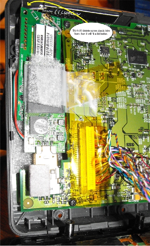

Posts: 2825
Re: Best USB 2.0 connections on CPU side of Motherboard
I tried the wireless card on the motherboard USB connections and it works fine.
Cutting off the USB connector (desolder it) and connecting four wires to the four holes next to it.
For the time being soldering these wires to the motherboard connection and mounting the wireless card behind the USB SSD card in the interior of the Joggler.
I need to find a mini 4 pin connector.
Getting kind of warm after an hour or so.
Here's a picture.

Today "sealed" the case shut with the screws. Before doing so looked to make sure that the USB SSD stick was pretty flush with the motherboard. It was. I think that the wireless stick is just getting hot from it being used. It snapped shut easily.
I'll let it continue to run as configured.
