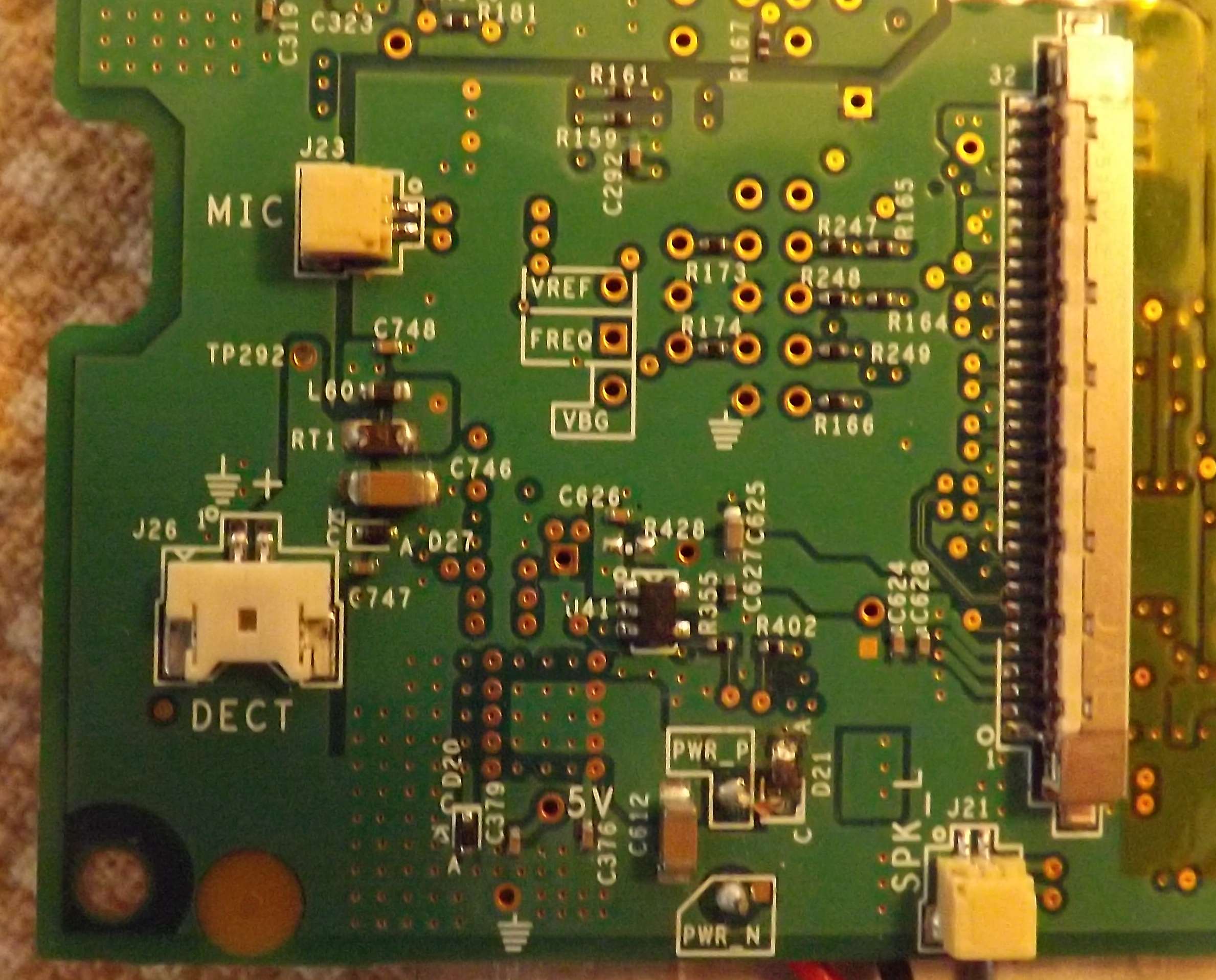

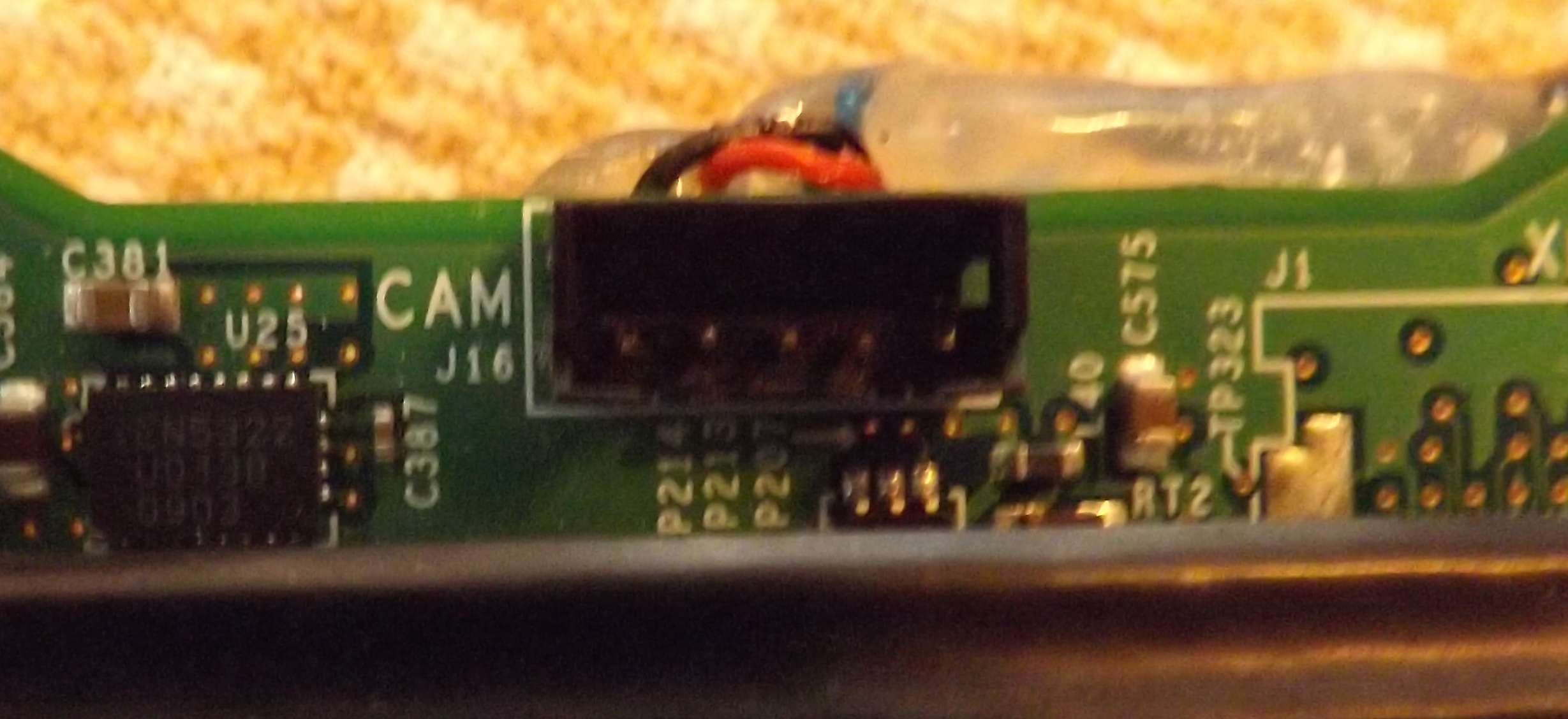

Here see the microphone inside on the Openpeak 1. It is soldered on to a pad with a plus and minus on it. Actually there are two microphone wells on the Openpeak1. Will check to see if it works...never done that before.
Guessing here that the mic belongs to the USB audio which connects to the DECT chip.
Took pictures and will upload shortly.

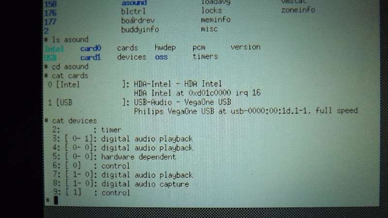

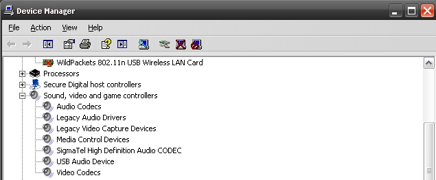

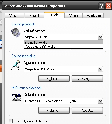

Yes. The XP machines show two audio cards.
The microphone does not work. Guessing it is plugged in to the DECT chip.

Here are pictures of the microphone connection.
There used to be a bunch of stuff on the internet relating to DECT chip modding and stuff relating to Linux and it is all gone these days.

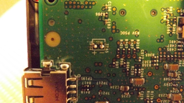

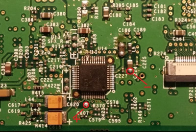

Mic seats on port B it coresponds to pins 21-22 on the chip they are shorted that means they where intended to use with mic .
And you can find it coresponds to to a TP lower I marked it with + and I tooked also ground from the main ground but mic still doesn't work.
Interesting thing when I touch this pin and arecord it makes some noice in audio file that means it's working as input but how to connect the mic to it I don't know for now....

So here you are using an OP1 as I see the ZIF clip there and your device doesn't have a microphone?
Wierd because I only see the microphones on the OP1's in one of the two little cubbies on the bottom of the case.

Yeah there are two microphone slots on the OP1 with one soldered microphone (pictures above). I will have to look again at the OP2 that I have taken apart as it had the microphones connected via connectors. It is totally disassembled as I had been modding the board .

dmesg only shows one audio chip
snd_hda_intel 0000:00:1b.0: enabling device (0000 -> 0002)
snd_hda_intel 0000:00:1b.0: PCI INT A -> GSI 16 (level, low) -> IRQ 16
snd_hda_intel 0000:00:1b.0: setting latency timer to 64
input: HDA Intel MID Mic as /devices/pci0000:00/0000:00:1b.0/sound/card0/input3
input: HDA Intel MID Mic as /devices/pci0000:00/0000:00:1b.0/sound/card0/input4
input: HDA Intel MID Mic as /devices/pci0000:00/0000:00:1b.0/sound/card0/input5
input: HDA Intel MID Line-out as /devices/pci0000:00/0000:00:1b.0/sound/card0/input6
input: HDA Intel MID Headphone as /devices/pci0000:00/0000:00:1b.0/sound/card0/input7

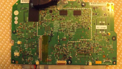

Only see one Microphone jack on the OP2 motherboard. On the OP1 the microphone is wired to the motherboard.
Note that the Joggler O2, OP1 and OP2 are totally different motherboards but similar in design.
The OP Joggler O2 doesn't have DECT or Zigbee or as far as I know the USB sound card. Thinking the microphone traces you see on the O2 are leftovers from the OP1 design but never utilized in the O2 Joggler.

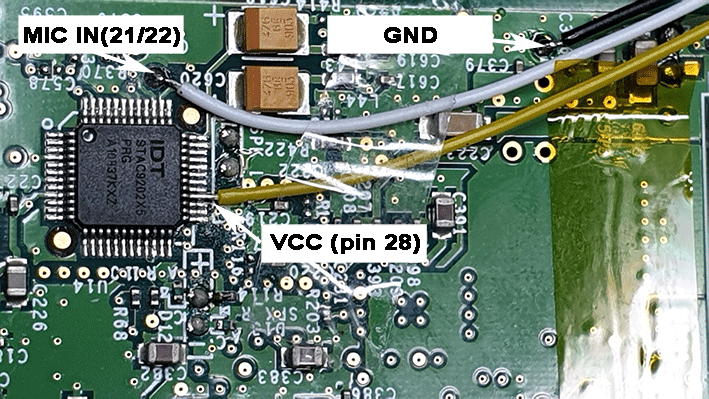

Hi guys,
In case you are interested about adding microphone into your Joggler maybe these informations will help you.
The STAC9202 supports analog stereo microphone and pins 21/22 are used for this purpose.

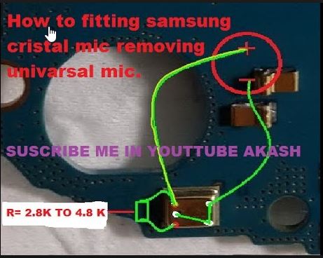

According to Wikipedia,the basic electret microphone powering circuit use only one resistor and one capacitor :
I didn't found information about typical values to use with STAC9202 so I used 10K resistor and 1uF capacitor.
However, results aren't perfect as I got some background noise during my test (maybe adding EMI filter could help...will take a look at it later)
I've used VREFOUT-B (pin28) for microphone bias voltage. I've attached pinout for better understanding : You have to be sure your capture device is set to Mic and level is adjusted correctly with alsamixer (F4).
If you get some errors trying to execute arecord, just edit /etc/asound.conf like this :
pcm.!default {
type plug
slave.pcm "asymed"
pcm.asymed {
type asym
playback.pcm "dmixer"
capture.pcm "hw:0,0"
pcm.dmixer {
type dmix
ipc_key 1024
slave {
pcm "hw:0,0"
period_time 0
period_size 1024
buffer_size 4096
rate 44100
bindings {
0 0
1 1
ctl.dmixer {
type hw
card 0
arecord -f cd -d 10 -t wav -N test.wav
Best wishes !
