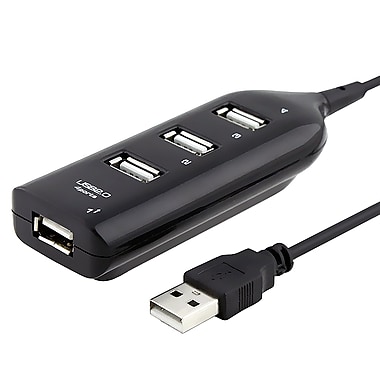

Here is a picture of the hub that I have connected to the interior on the motherboard USB 2.0 ports. I did glue and screw this hub to the back of the Joggler then cut the wires and soldered them to the motherboard.
Took it apart and used the tiny plastic Joggler screws in to the back little vent holes. Just a touch of hot melt glue was used and the top of the case did just snap back in to place.
