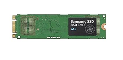

You can now also purchase USB to m.2 SATA cards and an m.2 SATA drive is really cheap these days.
