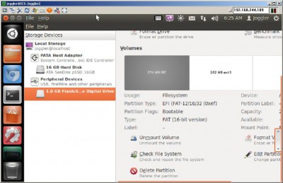

I increased the size of the first EFI boot paritition on the MMC some. Well went from around 60 to 250 Mb as there are some 4 subdirectories in it today with various boot set ups and I ran out of space yesterday playing with this. Going to try three boot setups with the EFI stuff; IE: the MMC, SSD or the USB stuff. I have enough room on the SSD to divide it up to multiple boot partitions which might work even better.

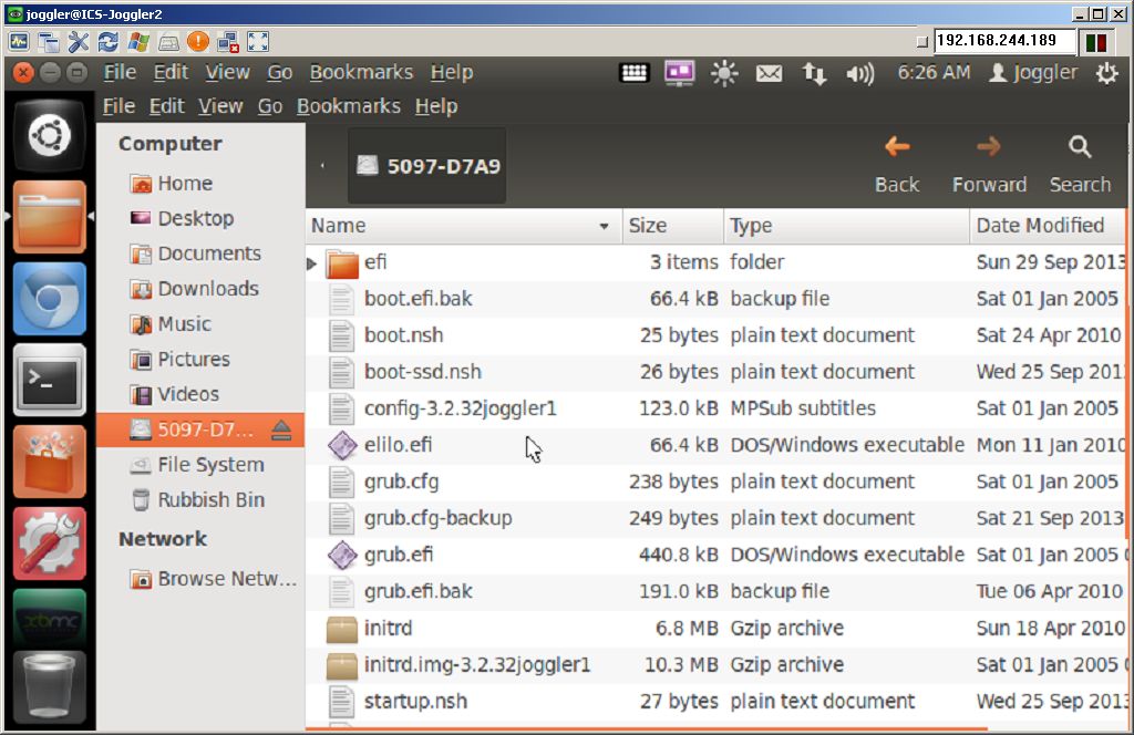

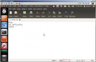

Current startup.nsh file reads:
Maybe I am not waiting long enough. I have startup.nsh set for three lines: FS0:, FS1: and FS2. All of the boot except for one which is grub. Maybe I should change fs1 to grub and fs0 to boot?

Expanding from 60 to 250 mb didn't work well as I see 250 Mb but only can utilize 60Mb. Probably need to remove the partition, reformat it to EFI boot then copy over the files.
expanded 60 to 250 efi boot but still sees only 60 Mb.
EFI directory for booting
GRUB configuration file
Refit configuration file
changed it to:fs2:boot
fs1:boot
fs0:grub
Still having an issue booting into the O2 stuff; but no issues booting into Ubuntu. Going to change the order though such that the Ubuntu SSD boots by default with the 2ndary icon being the O2 boot.fs2:boot
fs1:grub
fs0:boot

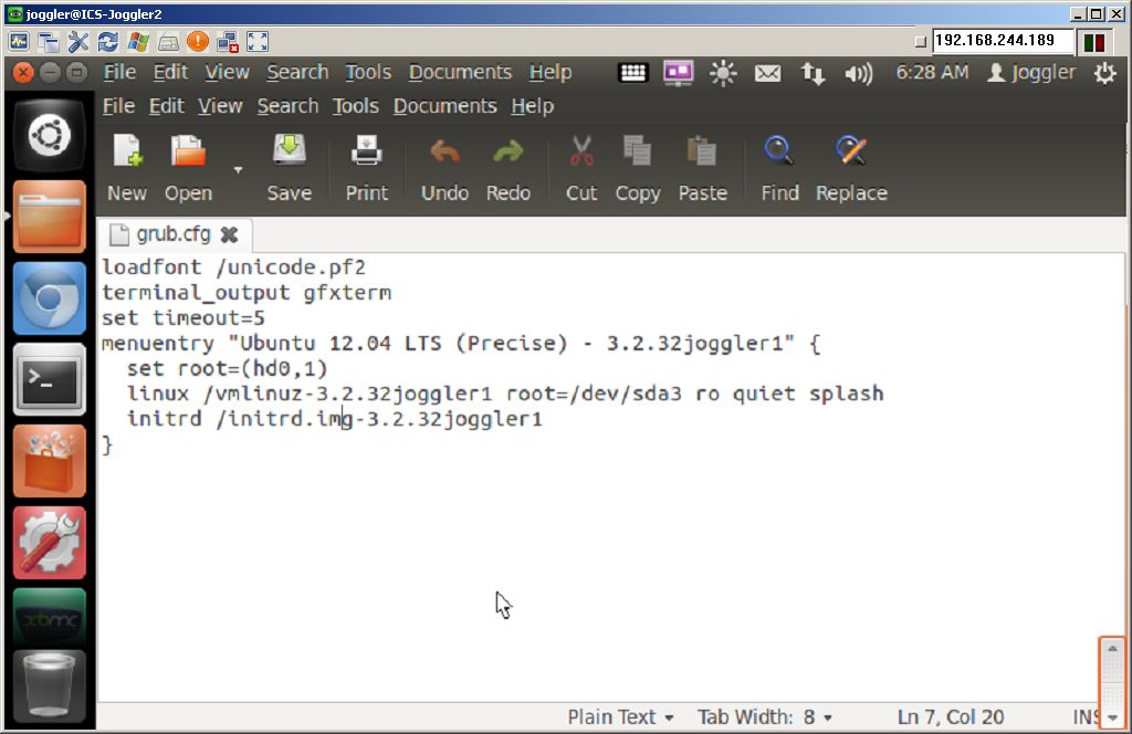

I have two grub.cfg files now.
One in the root efi directory:
and another different one in the \efi\tools directory. (BTW it looks wrong)loadfont /unicode.pf2
terminal_output gfxterm
set timeout=5
menuentry "Ubuntu 12.04 LTS (Precise) - 3.2.32joggler1" {
set root=(hd0,1)
linux /vmlinuz-3.2.32joggler1 root=/dev/sda3 ro quiet splash
initrd /initrd.img-3.2.32joggler1
should I copy the one from the root directory over to the \efi\tools directory?timeout=5

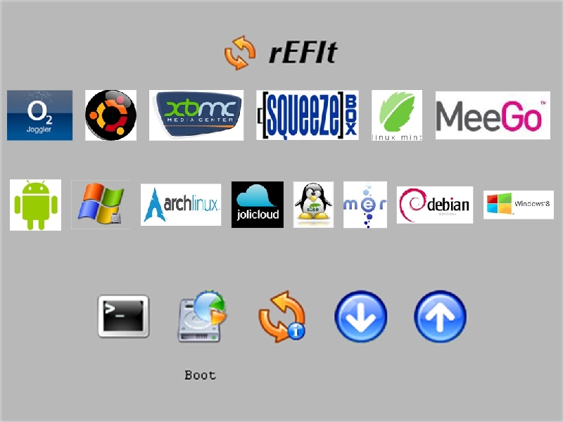

Here's a quickie rEFIi picture of what the Joggler 2 can do once using an SSD drive.
Re: Has anyone rewritten the MMC flash to USB?
Pete this looks great , really want a Joggler 2 now lol ,have you had a mess around with refit on a joggler 1 ? I would love to triple boot , Mint , xp, xbmc os . or maybee more all loaded on an external hdd and booting like you have here .pete wrote:Here's a quickie rEFIi picture of what the Joggler 2 can do once using an SSD drive.
