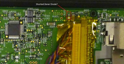

hey people, did anyone have any luck with the fuse issue. i think i have bricked my board using an incorrect power supply I have been testing the board and the component C267 appears to be misbehaving when testing it with the multimeter.
Although, i don't know what that is. any help would be much appreciated

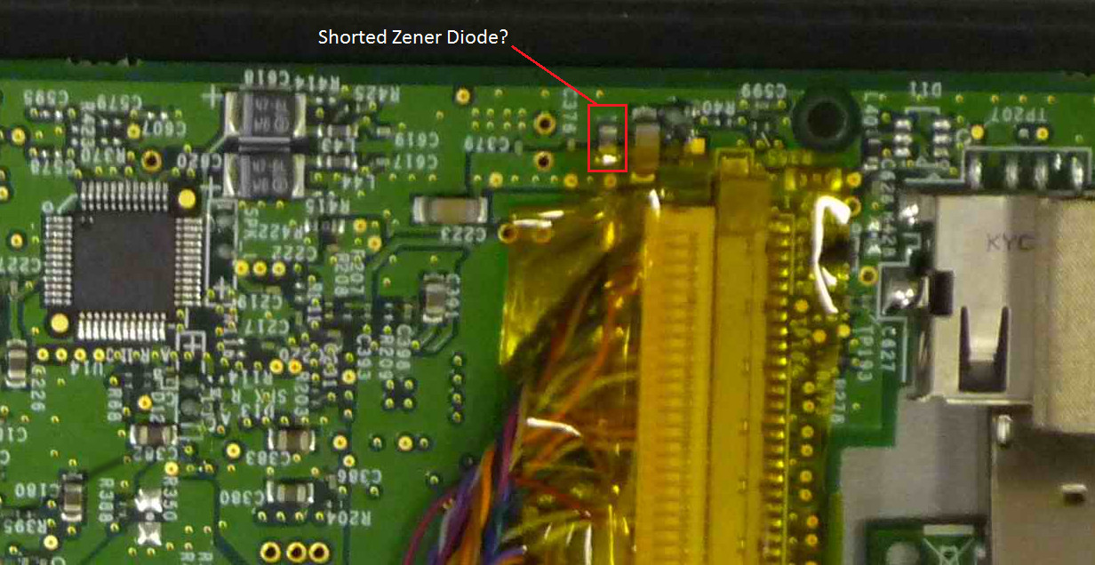

I was gifted a O2 Joggler that had a 19 volt power supply plugged in.
After removing the zenor diode used to protect the Joggler from voltage spikes etc it started working again.
If you remove the protection zener diode it will work, but the joggler will probebly fry the next time it gets too much voltage.
Possible Fix: Remove protection zener diode
