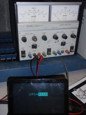

I'll try to measure the current the Joggler draws if it helps.
Just checked and its about 1.2A during startup
Current approx 1.2A during Boot

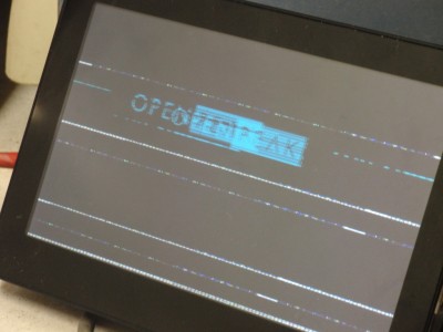

Made up the kit. Maplins do a 2.2A and a 3.0 Amp current trip, so used that instead of an inline fuse. To all those thinking of having a go, the 12V which is usually a 5mm 2.5mm plug and socket works fine, powers up external hard drives no problem at all. Checked it on a WWStars dual caddy, via firewire and USB, and WD MyBooks and is OK. Downside is the 5V rail from the power supply is not man enough to supply the Joggler. Screen intermittently flashes, and eventually reboots, so either the supply quality is not good enough (unlikely), or the 5V output is limited. Tried it on both a lead which was driving an unspinning DVD Rom, and also on a discrete supply with nothing else attached. Probably worth doing for powering up the External drives if nothing else as it saves on having adaptors and plugs all over the place.

Sorry to dig up such an old post... If you (or anyone else) is still looking to do this, it may be worth having a look in the BIOS menu of the PC in question to see if there are any voltage monitors; many motherboards can monitor the actual voltage put out by the PSU, as well as other "PC Health" readings like temperatures.
The ATX specification for power supplies allows for a ± 5% tolerance on both the 12v and 5v rails, so it could actually be supplying anything between 4.75v and 5.25v. I've noticed that my PC's PSU actually sits at around 4.8v, with the 12v rail at around 11.8/11.9v.
PC PSU's are usually a brilliant power source (I've got 12v and 5v jacks on the back of my PC, fed by the PSU), but it seems in this case that the Joggler has a tighter tolerance than the ATX spec can provide... The hard drives were OK because they are likely designed with the ATX tolerances in mind.
