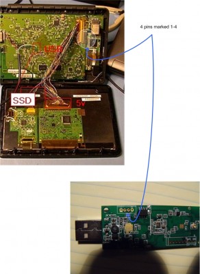

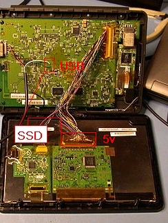

Do you think the SSD would fit inside the joggler utilizing the extra USB port? Keeping the WiFi Card in its original place?
Eg, Remove the USB port on the SSD and hardwire it to the extra USB port something like this? :-

No; but what are the dimensions of the space you have marked as SSD?
I have miniature 4 port USB hub and some "wires" with just the female ends of the USB ports; very small footprint; from playing with the Asus Netbook. My preference would be to put the Lenova Keyboard/Mouse dongle inside of the Joggler and just leave it there instead of using the outside USB port.
Its about the same size as the WLAN card out of its shell. I take another picture of it with a ruler and the WLAN card next to it.
Are the 4 open holes on the WLAN card near the USB port marked 1-4 USB connections? Could I connect a female USB port to those 4 open traces/holes?

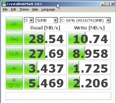

Here is a benchmark running with Dan's Windows XP SP3. The next few benchmarks will be done in a simliar fashion with the microdrive, IDE drive and a couple of different flash drives mounted inside of the Joggler (I have to take apart again anyways).
This attached picture is using the Joggler; running Dan's XPSP3 and application called CrystalDiskMark 3.0.1 with the new SSD USB (8Gb) drive.
