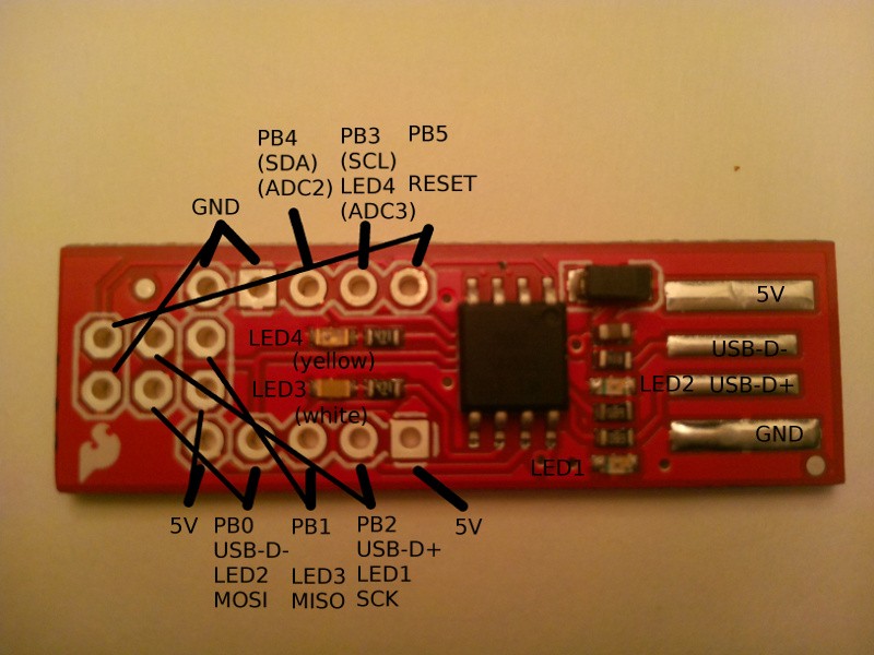

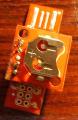

Re: Backup battery for clock?
This morning googling a bit found a USB based RTC clock.
Most if not all of my Jogglers has an extra USB port set up in them via a bit of thin wiring.
Installing a USB based RTC clock would be easier to configure both software and hardware wise. Well and you can hide it inside easy enough.
Going to give this a try as it is inexpensive and I can test very easy.
You still use the I2C interface for the RTC.
