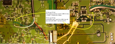

- from the Joggler Wiki and guessing this will work (be testing a bit)
TP137 and TP138 are similar, connected to bus 1 port 0 for USB 2 but will also work with USB 1.1 as bus 2 port 0.
Note that these USB ports will not be utilized for anything with a draw higher than 500mW (no hard drives etc).

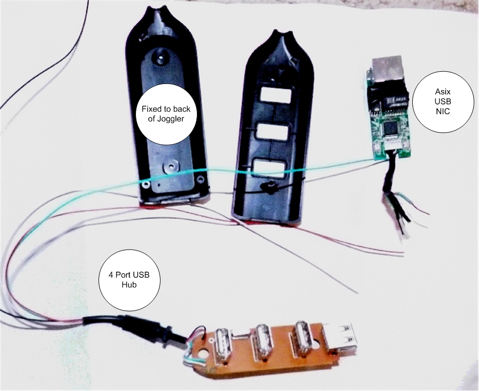

Started endeavor. A modification to original hub add will be an Asix NIC add removing the last USB port on the device. This will provide me with two network interfaces on the Joggler (well 3 including wireless).
I am thinking I can remove the last two USB ports and solder the USB cables from the Asix NIC to one USB port and it'll all fit inside of the little USB hub case.
This modification can turn the Joggler into a combination firewall and AP device with an LCD GUI to the web interface for example or just a screensaver.
The device will be attached to the back of the Joggler with two screws (no glue).
The USB wires are very thin which helps me route them inside of the case easily. They are also labled at the USB hub end which helps somewhat.

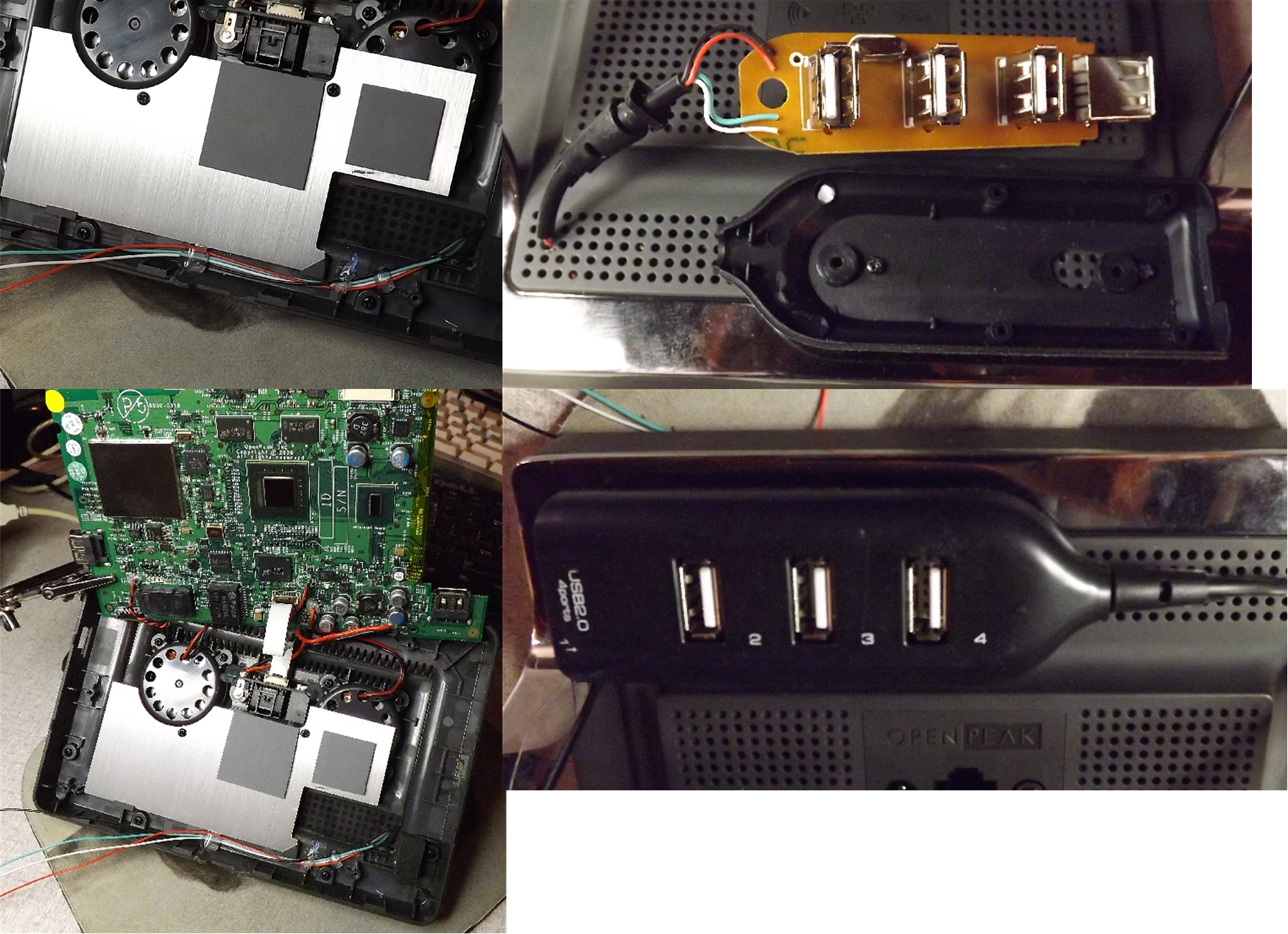

While the hub looks big; it is not. I used hot melt glue to route the wires inside.
Here using TP137 and TP138 for my connection to the hub. I am leaving the power connection to the external USB port as I do not use it anyways.
I used little drops of hotmelt glue to tack the thin wires to the motherboard. The four wires are routed on the inside rather than the outside of the motherboard soldered all 4 to inside points of contact (D-, D+, + and -)
Put it back together and tested it with an XBMC configuration. Works great. Added two Asix NIC USB devices and this is what I see.

Removed the interior boot XBMC stick and replaced it with the wireless stick and put the XBMC stick on the hub testing the XBMC boot with the wireless stick inside of the Joggler. Works fine.

Good stuff - and look at that fancy metal heatsink! :)
Re: New / Old Hardware modification with pictures
Yup; its not an O2 Joggler; rather its an Openpeak Joggler with the DECT / Zigbee and a metal heatsink device.
That said the mods would work the same as the motherboards are almost identical.
Over the years these devices were sold as Jogglers on Ebay. The only way to tell from the outside is the logo in the back of the device. (O2 versus Openpeak).
Most of my Joggler tinkering has gone to these and the larger Openframe devices (with the speakers in front). That said though I have a collection these days if bits a pieces of all of the Openpeak stuff.
