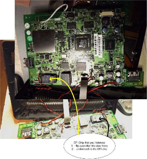

It is a flash chip located on the Joggler motherboard. I attached a picture to indicate where it is.
Carefully pulling apart the Joggler and turning it on; you can remove the EFI chip in vivo (hot swapping chip while Joggler is on); replace it with another chip and flash the 2nd chip. It is much simplier than it sounds and I myself was worried that I would cause more harm than good hot swapping my EFI chip.
I am not sure how many read writes the original chip has and it could maybe fix issues with a kaput joggler.

pete_c wrote:It is a flash chip located on the Joggler motherboard. I attached a picture to indicate where it is.

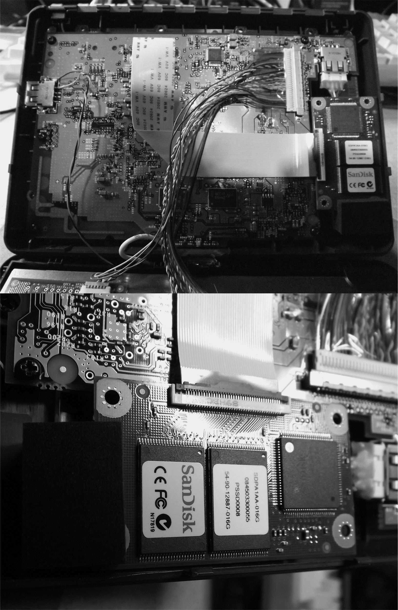

Making a second production (for use) makeshift Joggler using "Coreboot and Seabios" and an extended ZIF SSD pata drive.

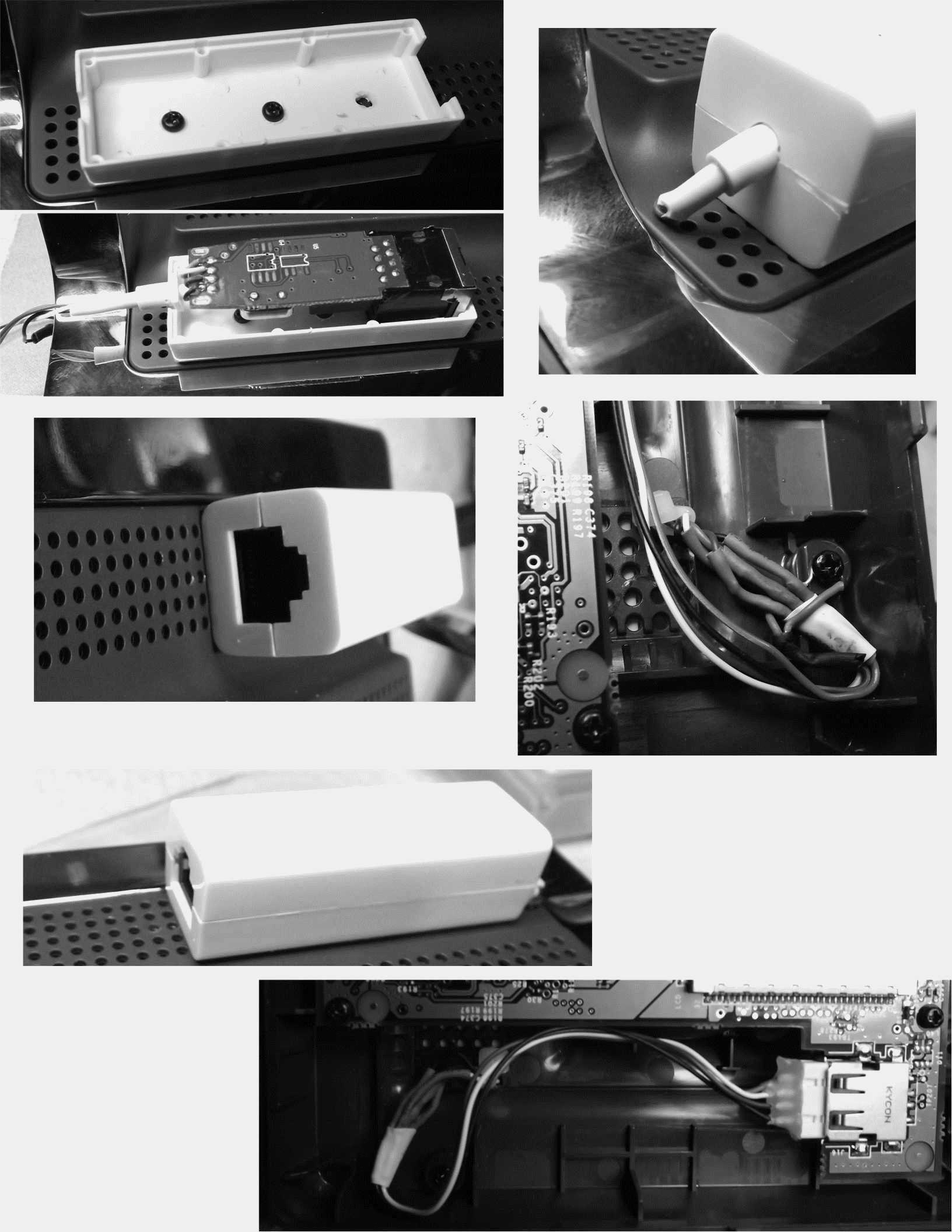

This one will be using a small footprint (apple style) USB to NIC interface sticking out back of the Joggler using the internal USB port or adding one inside to outside. Might be easier just to make a thin USB cable extending outside and fastening a small USB hub on the back of the Joggler. The USB wires are so thin that I can utilize the small "venting" holes on the top back of the Joggler case.

I am using a very small USB to NIC interface and historically I have glued it to the back of the Joggler. This time I may just use a couple of very small screws inside of the NIC part of the interface to fix it to the back of the Joggler using the aforementioned "vent" holes.
Here is a picture of the USB to NIC interface. Note this is a $1 cheapie USB to NIC converter. I couldn't find where I put the original cut end of the USB to NIC converter so made do with another connector. I was able to thread the 4 wires through one of the same holes adjacent to the USB to NIC device. Using my newly (but old stuff) set up soldering station, "extra hand clamps" helped a bunch to do this.

Playing with a new (old) Joggler today.
That said tested the XP USB boot initially to see if the internal NIC would come up or not; it didn't.
SSHing to it next to update the ROM to the coreboot.rom (also purchased some rom chips a couple of months back such that I would have some spares). ROM has been upgraded.
Writing an XP image to boot SSD drive. (pictures to follow installation of SSD Drive inside of Joggler).
Having it booting just fine into XP. Trying to now reimage the boot partition off a USB stick.
I attempted to keep the picture large by changing it from color to black and white.
I reduced the size of the files of the picture to 256K or less k from 1.2 Mb. The third set of pictures will show the ZIF SSD drive and extended ZIF cable inside of the Joggler.

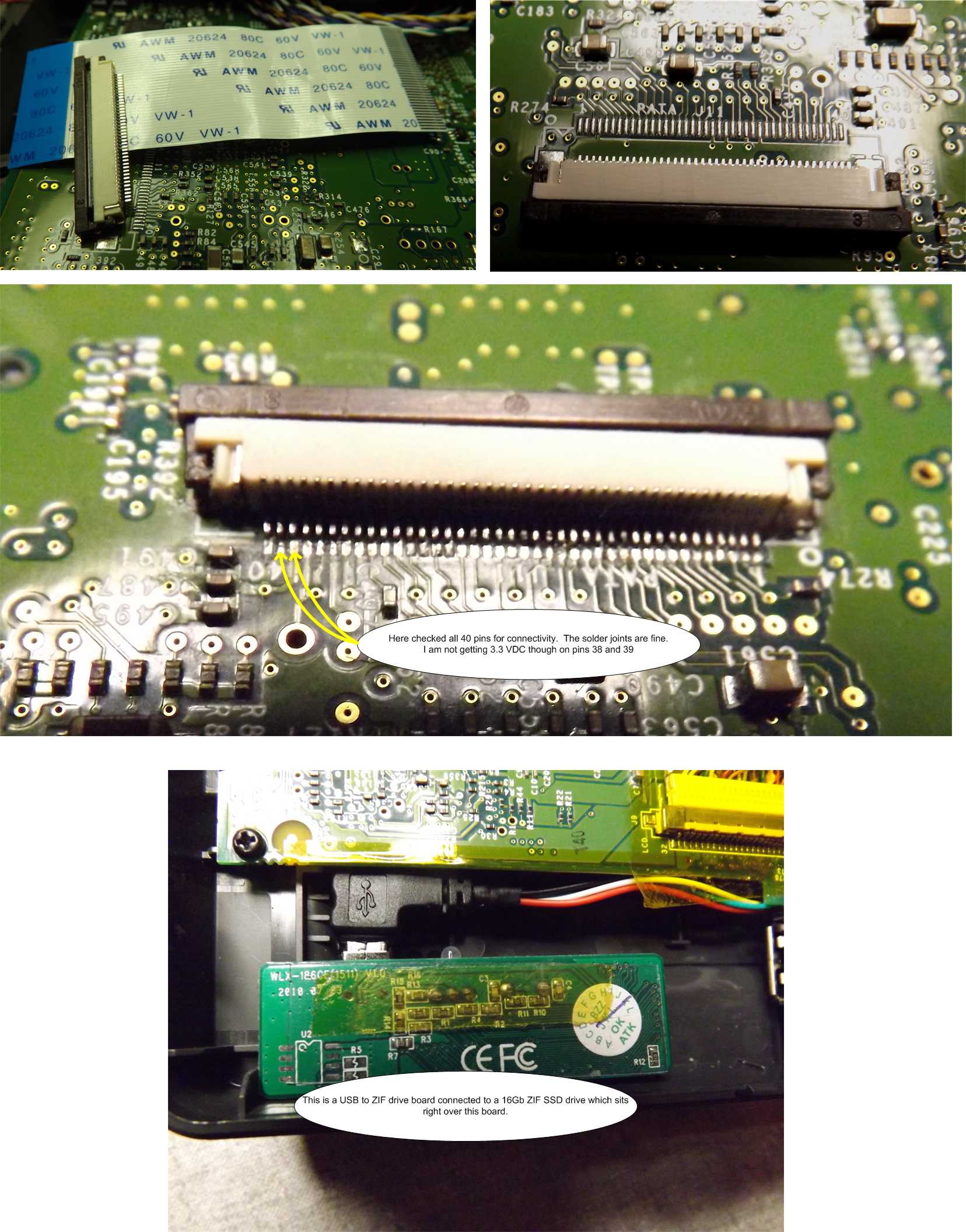

Today soldering a PATA ZIF connector on Joggler #4.
This said PATA ZIF connector is part of a batch of new ones that I purchased.
Looks to be well constructed but you have to kind of take it apart such that you can solder the two side pads to the Joggler Motherboard.
I will take pictures of said endeavor.
For whatever reason I cannot boot off of the PATA port with this connector and ZIF. I have double checked my connections and they are fine.
Now comparing this ZIF connection to a working ZIF connection. It appears that there is no 3.3VDC on pins 38 & 39 of the PATA connector; which is really a bit odd.
I am not sure why. Wondering if PATA traces are not connected?
That said the Joggler boots fine with the USB to ZIF device so installing that inside of the Joggler and hacking another USB connection for NIC interface.
