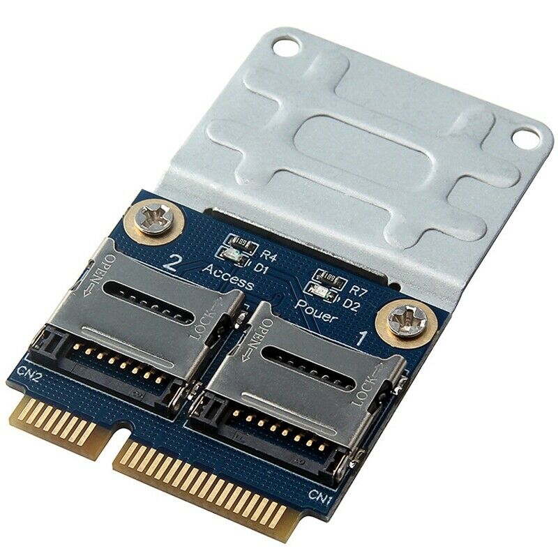

Maybe tapping in to the miniPCIE card slot with a boot device will work for a new booting device. Here tried a Crystal Vision HD card and it worked well at the time for KODI many years ago. Today you can purchase one of those mini pcie 1-2 port true sata cards.
You would have to remove the combo wlan / bt card.

Thanks will try to dig up some more USB sticks, and will also try with an USB SD card reader before investing in an miniPCIE adapter.
