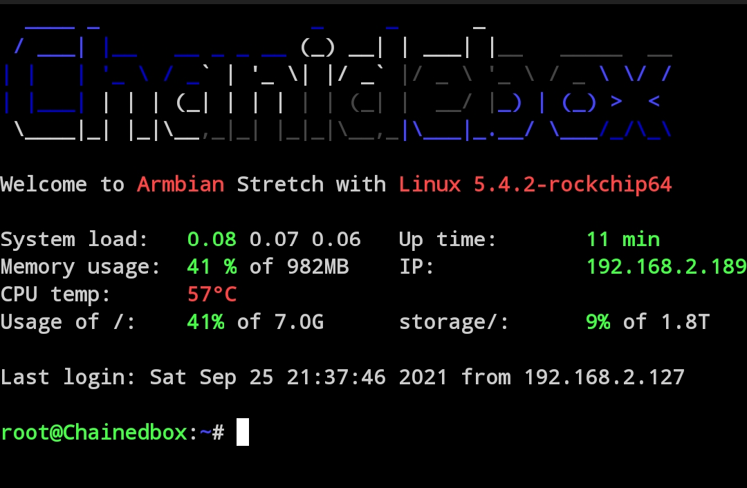

Rock version Armbian stretch

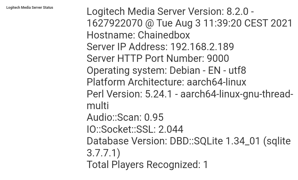

LMS 8.2
Man in a van
Posts: 511
Location: Staffordshire. UK
Re: Native flac not supported by joggler
Post by Man in a van »
Well, "two out of six is pretty poor" as Meatloaf sung in the demo
This is LMS v 8.2.0 on a raspberry piZero, running Buster Desktop
Logitech Media Server Version: 8.2.0 - 1627922070 @ Tue Aug 3 11:39:20 CEST 2021
Hostname: pizero
Server IP Address: 192.168.1.106
Server HTTP Port Number: 9000
Operating system: Debian - EN - utf8
Platform Architecture: armv7l-linux
Perl Version: 5.28.1 - arm-linux-gnueabihf-thread-multi-64int
Audio::Scan: 1.02
IO::Socket::SSL: 2.060
Database Version: DBD::SQLite 1.58 (sqlite 3.22.0)
Total Players Recognized: 1
I would suggest that first you make a backup of your current config.
Then update from Stretch to Buster, I see there is a download for Pine, then install (at least) LMS v 8.2.0 or better LMS 8.2.1 Nightly
http://downloads.slimdevices.com/nightl ... hp?ver=8.2
I have no idea why you have the problems stated in your first post, sorry :(

thanks buddy! I will try
