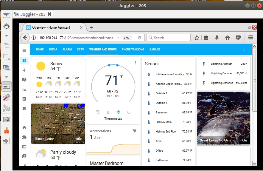

Here is a Firefox weather page on the Joggler.
https://birdslikewires.net/download/ope ... 5op.img.gz

Your link worked successfully - thank you. I noticed it was the older Kernel, which I hadn't tried. However installing that worked and I was able to successfully expand the partition with Gparted.
Chromium wouldn't install for some reason, but Firefox did, which will be fine.
