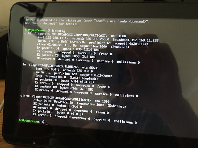

I just copied 3.16.85 to USB stick (and put the WiFi details in) and booted a Joggler with it.
It boots but is not picking up network interfaces (WiFi or Ethernet)
ifconfig only lists loopback.

Paul Webster
Posts: 160
Re: SqueezePlay for OpenFrame
Post by Paul Webster »
Update - I reimaged and this time did not personalise the network.yaml file ... and now it gets Ethernet IP address.
Paul Webster wrote: Wed Jun 24, 2020 11:57 am Before I reimaged I had a quick poke around the logs and saw wpa_supplicant reporting an issue with "line 12".
Double check the layout of your /boot/network.yaml file, something may have mangled it. Line 12 sounds like where your wifi SSID lives.
Ah, have you remembered to leave the semicolon on the end? That's caught me in the past.
Edit it and fire it up with
sudo of-netplan
Paul Webster
Posts: 160
Just looking at the original unedited file and I think I know what I did ...
good chance that I put the WiFi SSID after "YOURWIFINAME: " ...
will know in a few minutes.
Paul Webster
Posts: 160
That was it - sorry about the confusion.
