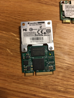

Sadly, using the BCM70015 Crystal HD card has not gone well. The kernel driver is old and only supports the quirky BCM70012 chip, which I don't have. I've managed to install the BCM70015 driver and the card is recognised, but getting recent software to use it is another matter.
I'll leave the Crystal HD card in the OF2 just in case I have an epiphany though. Breath holding is not recommended.

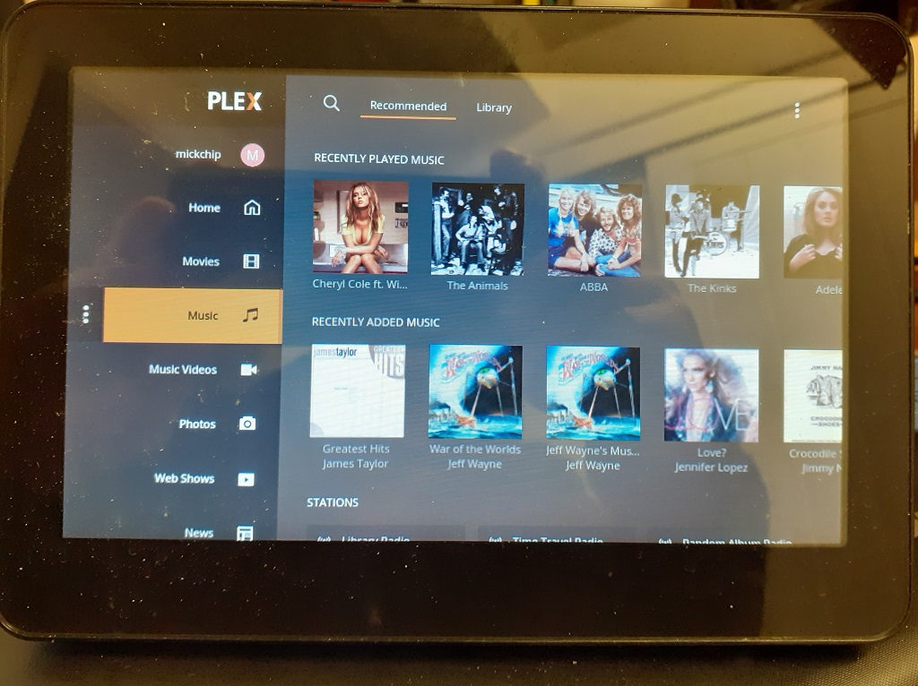

Just installed this, it does take awhile to install. Very impressed, a change from sqeezeplay.
Re: Plex Media Player for OpenFrame
Looks great , good work Pete , @mickchip is that running on Ubuntu ? It looks very good .
Sent from my VOG-L29 using Tapatalk
Yes, just followed the instructions on this page and connected to my server. Did try a music video but it's a no go for video.

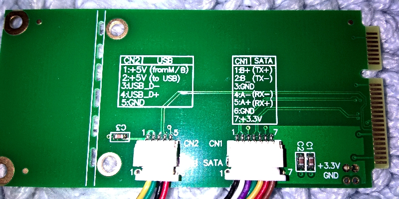

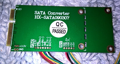

Checked out the mini PCiE to SATA card. It has no chips on it and just wires to connect to a SATA drive. It must be an mSATA card?? Can you connect a SATA drive directly to a mini PCiE port? Way back did try an mSATA card which did not work.
Here is a picture of the two sides of the board. It has a SATA and USB connector on it.
hxxp://www.soarland.com/USB_SATA_to_mini_PCIe_ ... t-502.html
  • No need driver, suitable for any small size USB device into laptop, it can be used for USB Card Reader for micorSD/M2, USB Disk driver, USB WIFI or wireless card
    Slot type: mini pci-e
    Expansion: 5-PIN USB 2.0 data
    Fastest read and write speed: 30M/S
    Support full-height or half-height cards
    It only can support the mini pcie slot with normal USB deification
    Pls make sure the MINI PCIE on your motherboard supports USB signals before purchase

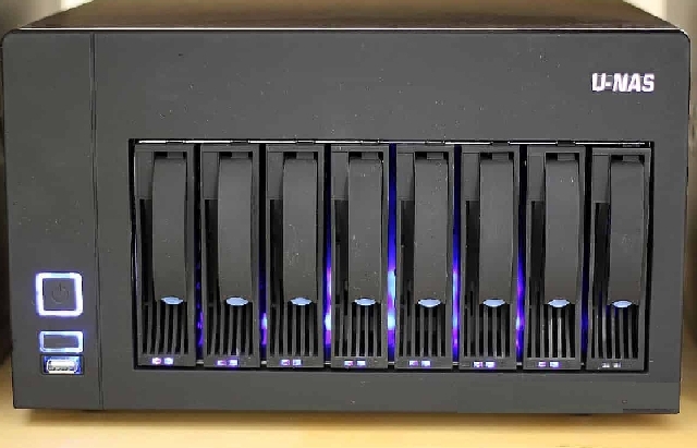

A few months ago rebuilt NAS and built a new NAS using XigmaNAS and ZFS and 8 SAS drives (versus SATA drives).
Still learning how to use ZFS and I am impressed so far with it. Now have two identical NAS boxes (one is a backup of the other).
Been a bit bored here. ;)

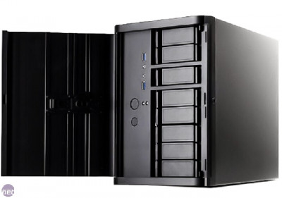

One NAS box is in a UNAS case:
and one is in a Silverstone case
