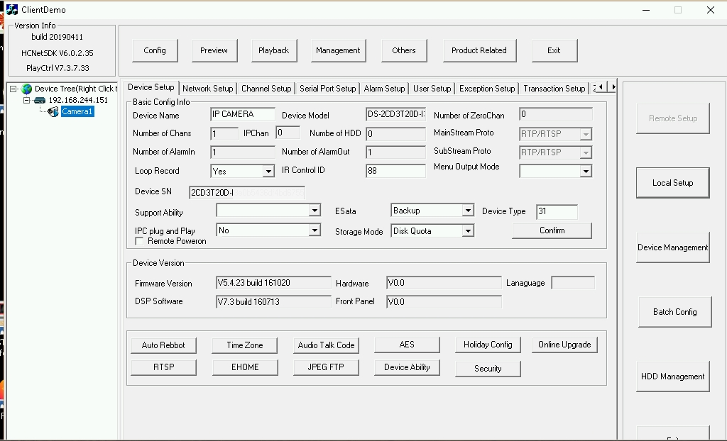

The client demo application is a bit overwhelming. Here it connects fine only it doesn't let you change much other than the basics. It works statically so if you make a change to the camera firmware it only will work until the next reboot of the camera. Old Hikvision application works in Windows here via VPN locally. IE: for the video doorbell I can see events via Hikvision application on my cell phone via VPN.

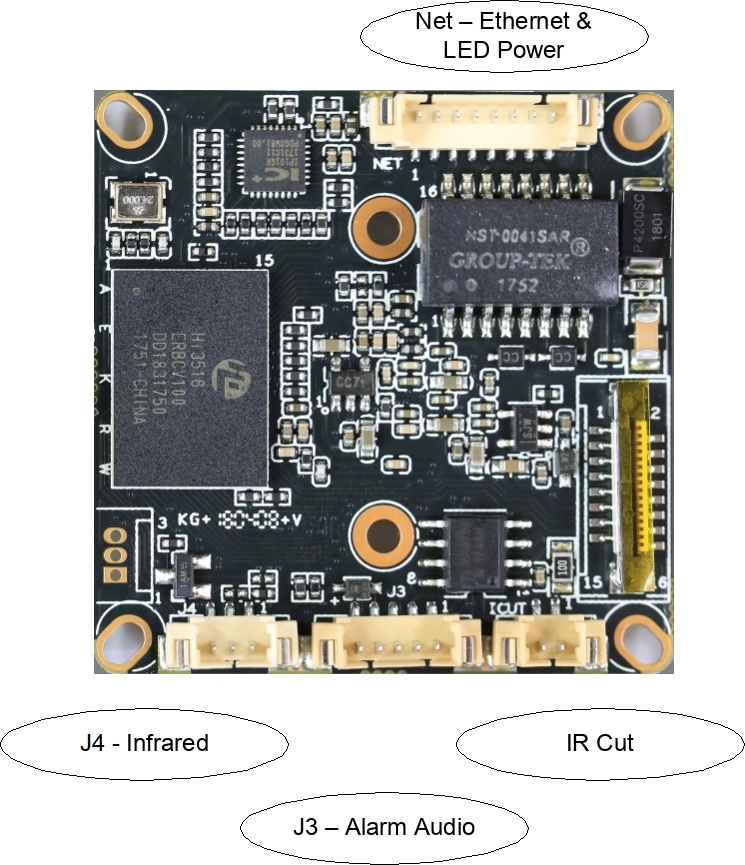

Found a shop on Ebay for these camera boards. The two I purchased were $20 each with free shipping. These were 4-5 MP boards. The shop also sells 10 MP boards. They also sell the POE and WLAN modules for the boards. The boards also come with microphones.
Here is a picture of the browser settings which only works in IE. Not in chrome or firefox.
Here is a picture of the camera board:
Here is a link to the SDK with client demo.
https://onedrive.live.com/?authkey=%21A ... ion=locate
Here is a view of the client demo:
The reason originally many years ago for going with the Grandstream 1 Mp board was SIP. The Grandstream boards were double stacked 38 mm boards.
These are single stacked boards.

Yes the client demo has been used to enable SSH and Telnet to be able to tweak while connected to the demo where you can make changes to the firmware via SSH / Telnet.
