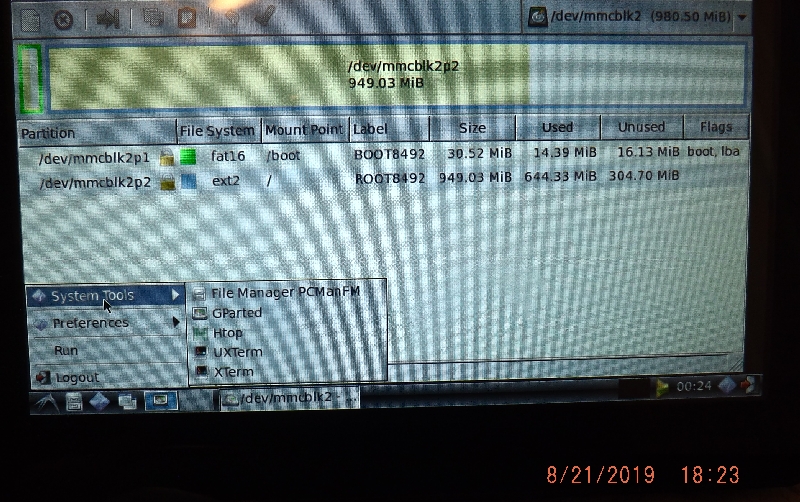

There are a few things which are a bit different to previous images; most notably this is a command line only image, created to be as 'vanilla' as possible. This means you can use instructions available for any Ubuntu Bionic system to install whichever GUI environment you might like. Or none at all if you just want a single-use system.

- Single image for any OpenFrame.
- Built for size; about 430 MB space used initially.
- Fully working audio and OpenGL with kernel drivers.
- Automating scripts for completing common tasks (eg. installing X.Org Server).
- Support for the Realtek 8821CU combined 5 GHz WiFi and Bluetooth 4.2 module.
- Simple before-boot wireless network configuration.
