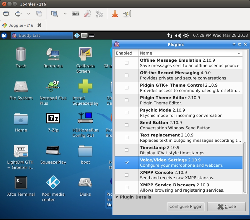

Installed Pidgin and a Skype plugin.
https://github.com/EionRobb/skype4pidgi ... r/skypeweb
Looks to be working. Here is an RDP session.
-=xXx=-
Posts: 128
Re: Joggler Ubuntu 14.04.05 EMGD + Kernel 4.4.121
Post by -=xXx=- » Thu Mar 29, 2018 2:57 am
No Audio and Video.
