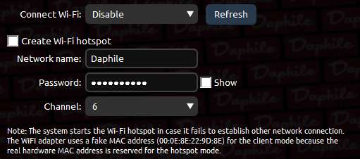

You can also configure it as a wireless hotspot for music.

I ran Daphile without internet access and it presented itself automatically as a WiFi hotspot , I was able to access the graphical interface via my phone and get it to start and stop the one tune it had on there .
This would be ideal for anyone with a large music collection on a HDD without internet connection to have access to all your albums :-)
