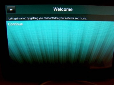

(I have tried to install Squeezebox Server on a PC and the joggler can see and play my music from "Mysic Folder") - OK
What is important for me is "My Apps" ! that has to do with my mysqueezebox.com account.
When I do the "rm -rf ~/.squeezeplay" reset it still remenbers some information I think...... It remembers my Squeezebox Server information and NEVER asks me to type in my account information (Mysqueezebox.com)
Try to look at some pictures I took - my written english is not perfect - so better for me to take fotos that I hope can speak for themselves..... Look at the picture numbers for chronological order !!! ( 1 , 2 , 3 , 4 , 5 , 6, 7 )
I tried to reset the Squeezeplay from with in the Squeezebox Server interface - did not work.
The thing is still; that I whant to log into my own account, se "My Apps" and reset the squeezeplay for real ??
Kind regards
Andymark
