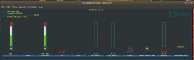

Re: Finally cracked it!
Installed newest OS / Squeezeplayer (Ubuntu Bionic (Kernel 5.10) for OpenFrame) on my O2 Joggler here.
Wrote image to a 32Gb tiny USB stick. Installed WiFi stuff. Time zone. Installed Squeezeplayer and rebooted.
Squeezeplay came up right away.
Only concern is that I have a loud buzz on the audio via internal speakers and speaker jack when at the Squeezeplayer menu.
When I plug in the external audio the internal speakers remain on. Other than that it's running great and same as previous version and now with a new Kernal.
So took the USB stick to another O2 Joggler / Squeezeplayer. No buzz at all now except that the sound continues to play on internal and external speakers.
Went to the Alsa Mixer and tinkered a bit with muting but do not see any features relating to muting on the Line out stuff.
I was able to turn off the local speaker sound plugging in the sound jack. It also works locally now removing the sound jack doing a couple of things...
write this new file ==> /lib/firmware/hda-jack-retask.fw

Posts: 1769
pete wrote: Wed Apr 13, 2022 4:53 pm I am good now except for a bit of crackle.
That's interesting, I wonder if anything has changed in the latest kernel release because that behaviour is exactly what I observed as being fixed now.
What EFI/BIOS were you using?
In alsamixer there should be an option for muting... I think it's Line Out + Speaker or something like that. Not near a Joggler at the mo, so can't check.
This is an original O2 Joggler with only the Avaya EFI bios and Realtek chip mac update using an external 32Gb USB stick (Tiny Samsung one).
First thing I tried was the alsamixer. There is no option for line out and speaker on it.

	Kernel driver in use: r8169
Never have seen an internal speaker audio jack thing on AlsaMixer.
root@openframe:/home/of# fuser -v /dev/snd/*
                     USER        PID ACCESS COMMAND
/dev/snd/controlC0:  squeezeplay    660 F.... jive_alsa
/dev/snd/pcmC0D0p:   squeezeplay    660 F...m jive_alsa
/dev/snd/timer:      squeezeplay    660 f.... jive_alsa
root@openframe:/etc/modprobe.d# ls
blacklist-ath_pci.conf  blacklist-firewire.conf     blacklist-rare-network.conf  iwlwifi.conf
blacklist.conf          blacklist-framebuffer.conf  hda-jack-retask.conf         of1-stac9202.conf
root@openframe:/etc/modprobe.d# nano of1-stac9202.conf
root@openframe:/etc/modprobe.d# cat of1-stac9202.conf
options snd-hda-intel patch=of1-stac9202v5.patch
Found this quickie fix about crackle and pop.
sudo echo -e '\n# Disable snd-hda-intel power saving\noptions snd-hda-intel power_save=0 power_save_controller=N\n' >> /etc/modprobe.d/alsa-base.conf
Trying this now...
BTW here is the patch file: (NOTE: got it working by adding the hda-jack-retask.fw patch file used in 2019 with then current version of Ubuntu)
root@openframe:/lib/firmware# ls
bcm70012fw.bin  brcm                htc_7010.fw           of1-stac9202v4.patch  rt2870.bin        rtl8821cu_fw
bcm70015fw.bin  hda-jack-retask.fw  of1-stac9202v3.patch  of1-stac9202v5.patch  rtl8821cu_config
root@openframe:/lib/firmware# cat of1-stac9202v5.patch
[codec]
0x83847632 0x00000100 0
[pincfg]
0x07 0x01c5e150
0x08 0x01451130
0x0a 0x90170150
0x0b 0x02a19020
0x0c 0x01813021
0x0d 0x0321403f
0x10 0x500701f0
0x11 0x90330122
0x15 0x50a001f1
