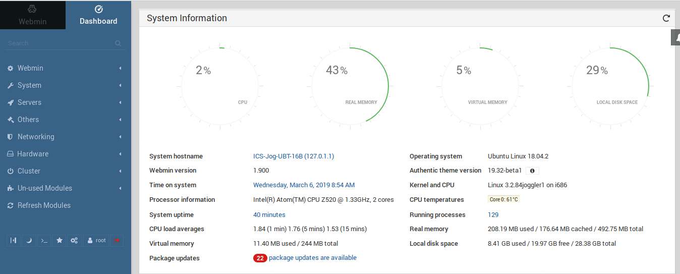

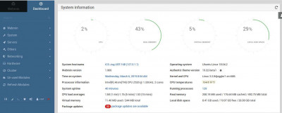

@Gary,
Resurrected the network on my modded Openframe box such that I have XUbuntu 18.04 running fine now with the Gb ethernet port and Wireless.
Webmin shows:

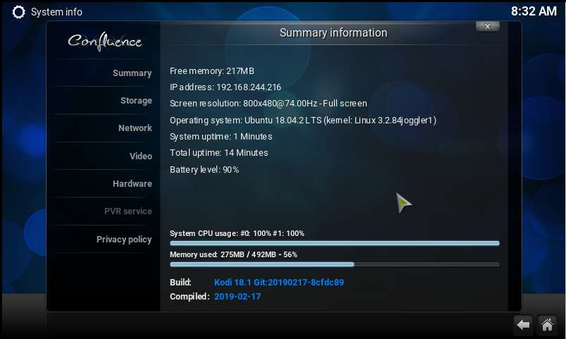

I installed current version of KODI on it and it works fine. Also installed SqueezePlayer and it works but doesn't save my settings and wondering why.
KODI works but it is not using hardware acceleration rather VMWare drivers for Video.
This is what I see with video:
root@ICS-Jog-UBT-16B:/home/joggler# lspci | grep VGA
00:02.0 VGA compatible controller: Intel Corporation US15W/US15X SCH [Poulsbo] Graphics Controller (rev 07)
root@ICS-Jog-UBT-16B:/home/joggler# sudo lshw -C display
*-display UNCLAIMED
description: VGA compatible controller
product: US15W/US15X SCH [Poulsbo] Graphics Controller
vendor: Intel Corporation
physical id: 2
bus info: pci@0000:00:02.0
version: 07
width: 32 bits
clock: 33MHz
capabilities: pm vga_controller bus_master cap_list
configuration: latency=0
resources: memory:d0100000-d017ffff ioport:f070(size=8) memory:c0000000-cfffffff memory:d0180000-d01bffff
Updated Intel drivers to opensource just to see if it works.

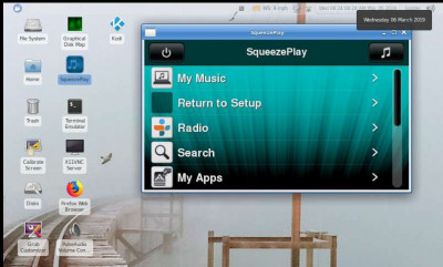

I installed Squeezeplayer from the Squeezeplayer repository as tried using Andy's but it would not work with Ubuntu 18.04.
It must be some setting with Squeezplayer as I configure for full screen on the Joggler and it sees all my other Jogglers BUT when I exit it never saves the settings and I have to reconfigure it. I do not now what I am doing wrong. And now the player screen works but never comes up. I have installed it some 3 to 4 times now with the same results. Might be missing something here in the settings. Are the dynamic settings stored some place other than the /opt/squeezeplay directory?

Using one of those NOOElec USB to test. Works fine directly and via VNC.
Got Squeezeplayer to work fine now. Saves configuration and I see it on the Squeezeplayer website as a registered device with my custom mac address.
