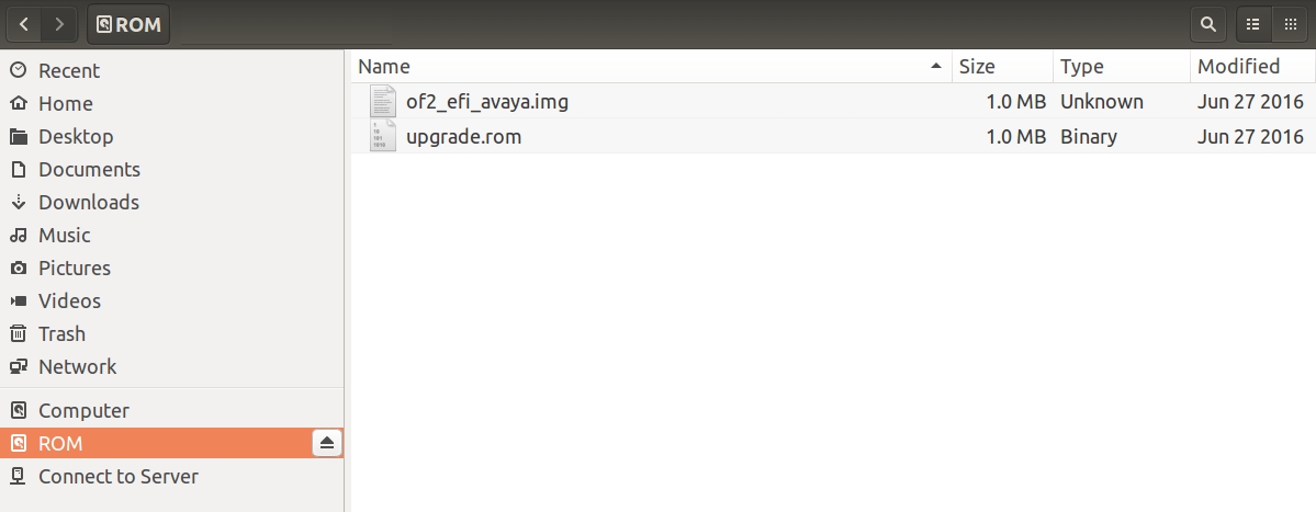

2 - create a fat32 USB stick and copy over the Avaya ROM. Rename the Avaya ROM to what upgrade.rom such that Seabios F7 boot will recognize the Avaya ROM file. Boot up Cisco Openpeak 2 and hit the F7 key while booting. Takes a bit of time. Wait until completion then hit a key to reboot.
Interruption of said write will brick you Cisco Openpeak 2 device and the ROM chip is soldered in to place such that there is no fix if you brick it.
Will attach pictures of the update to Avaya. At this time thinking that the 2Gb MMC was trashed and personally reformatted it with no OS. Leaving it like this for now.
