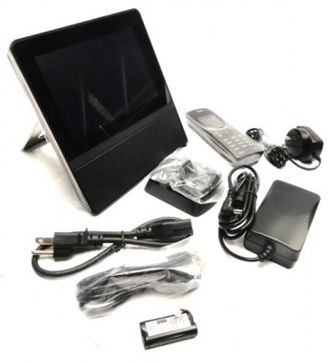

I am new here, so maybe my question is brought up before. I got 2 Openpeak (OPOF2B2110) for free, these have been used in Norway as "Telio Touch"
Do you guys now if OS can be replaced or updated? To shame to trow them in the carbage. They work fine, with a very responding touch screen. The problem
is that Telio's appshop do no longer exist.

The OpenPeak with the speakers in front of it has the boot ROM chip soldered in to place.
Above I have posted a ROM that will work for you.
The most difficult piece of your endeavor is to blind type interrupt the boot process. Once you have this done then the rest is easy.
The smaller Openpeak device which is the same size as the Joggler is much easier to modify and play with.
This one is labeled Openpeak rather than O2. It also has an IDE ZIF clip already soldered in to place inside for an easy to SSD upgrade.

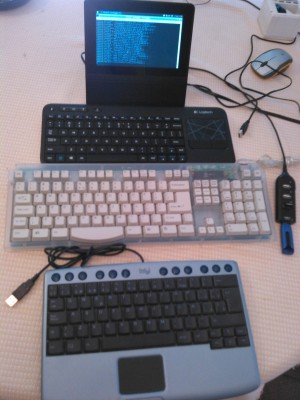

I tried a variety of keyboards / USB hubs for the EFI blind typing thing.
Ideally if you have a USB keyboard with USB ports on it that might work better. (think I have an HP keyboard like this).

Yep Pete , I tried two keyboards and two hubs before I got the right combination , keep trying

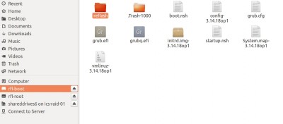

Here is a picture of the files / structure of the EFI boot partition on the boot USB stick to reflash which I am going to use now instead of the Ubuntu build. Will reflash the MMC such that it boots with the Cisco logo to the 2Gb flash on the device. Note file named boot.nsh.
Whatever I did I cannot get reflash to run. It looks like it starts then goes to the MMC partition where it just trashes out the boot.

Here are the two original USB keyboards that I used. Note the second one with the touch pad didn't have an escape key.
Easiest to work with but not do the esc key blind typing is the Logitech wireless keyboard. Easiest for the ESC key blind typing thing was the plan keyboard in the center. Note too the USB hub that I used to boot USB stick via blind typing. El cheapo ebay special.
Note that the bottom keyboard is a special Intel USB keyboard used for an Intel all in one computer that looked like a MAC but was only sold in Spain as an AOL computer in the 1990's. It was an interesting computer. I was able to get one and modify the computer inside of it to make it faster. I also stuck a TV tuner inside of it such that it worked as a television and computer (CRT monitor).
