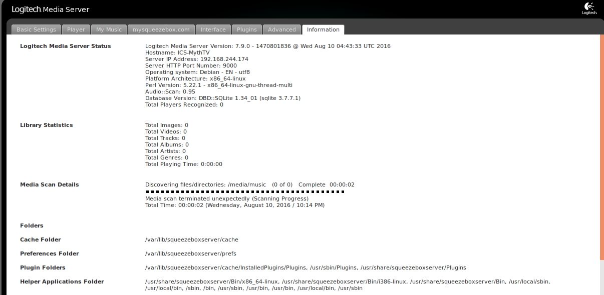

4 - That said when I go to the Squeezebox server to the same directory; it doesn't see it and I cannot put my music in the squeezebox configuration.
Discovering playlists: /media/music (0 of 0) Complete 00:00:04

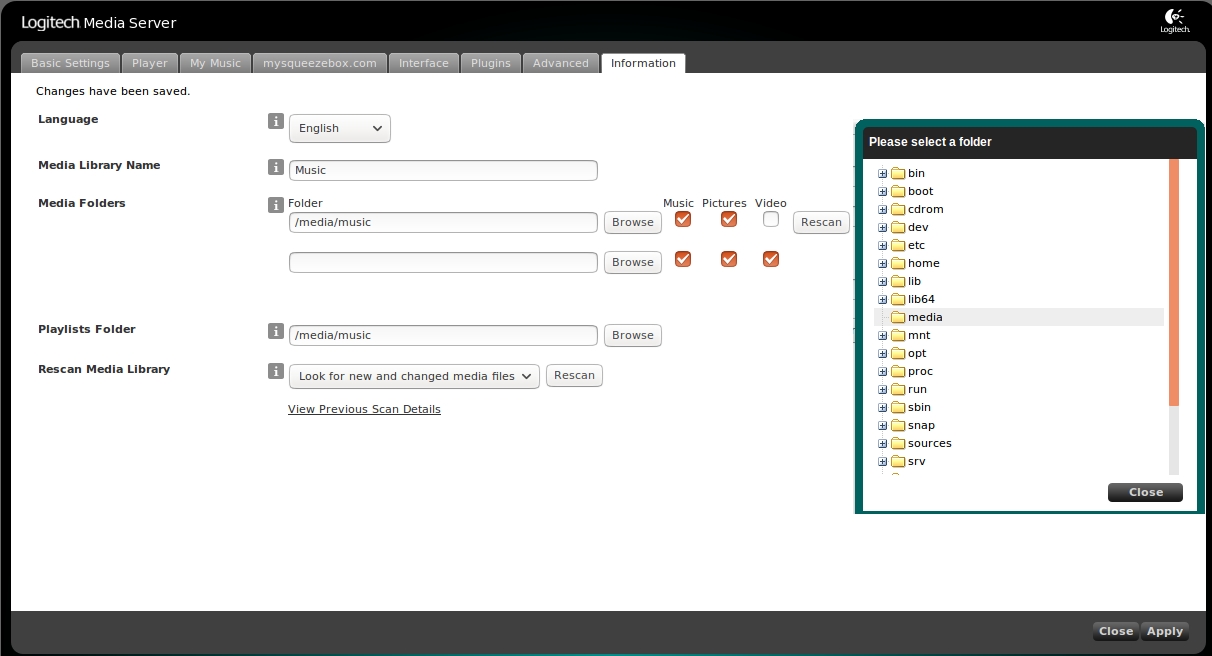

You need to go to Settings-Basic Settings - set a Media Library name - then add /media/music to both Media folders and Playlist folder - then do a full Claer Library scan under Rescan Media Library. Don't forget to hit Apply.
Re: Please help with Squeezeserver configuration
Thank you castalla.
Done that. Same errors. Last time I change something in the mounted directory such that LMS saw it. I know it's a rights issue from LMS to the directory.
