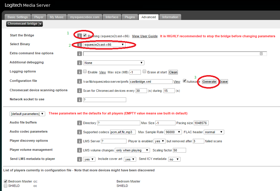

joggly
Posts: 25
Joined: Wed Jun 26, 2013 3:59 pm
Re: Squeeze OS with Chromecast
Post by joggly » Tue Dec 13, 2016 2:03 pm
I've mine working perfectly. For ref to anyone in future, my settings are as in attached.
1) Tick on "start the bridge"
2) Select from drop down on Binary. Either of x86 works
3) Click Generate to find your chromecast.
PS: Jetpac's problem is different as he already can see chromecast on player selection.
