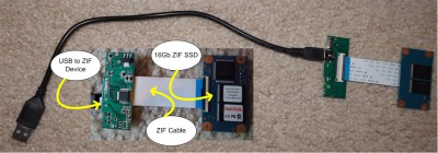

A - Checking the SSD card connected it via a ZIF cable to a USB to ZIF to SSD card set up. You can format the card with windows or with linux GParted. I did it in windows because I have a windows setup nearby. I will take pictures.
USBTOZIFTOSSD
USBTOZIFTOSSD

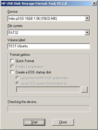

Formatting step 1 using a USB to ZIF PATA connector to SSD card

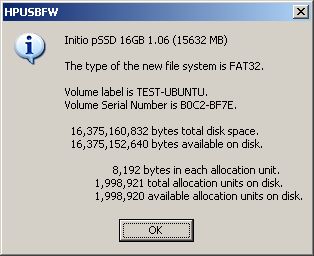

Formatting results
Formatting results

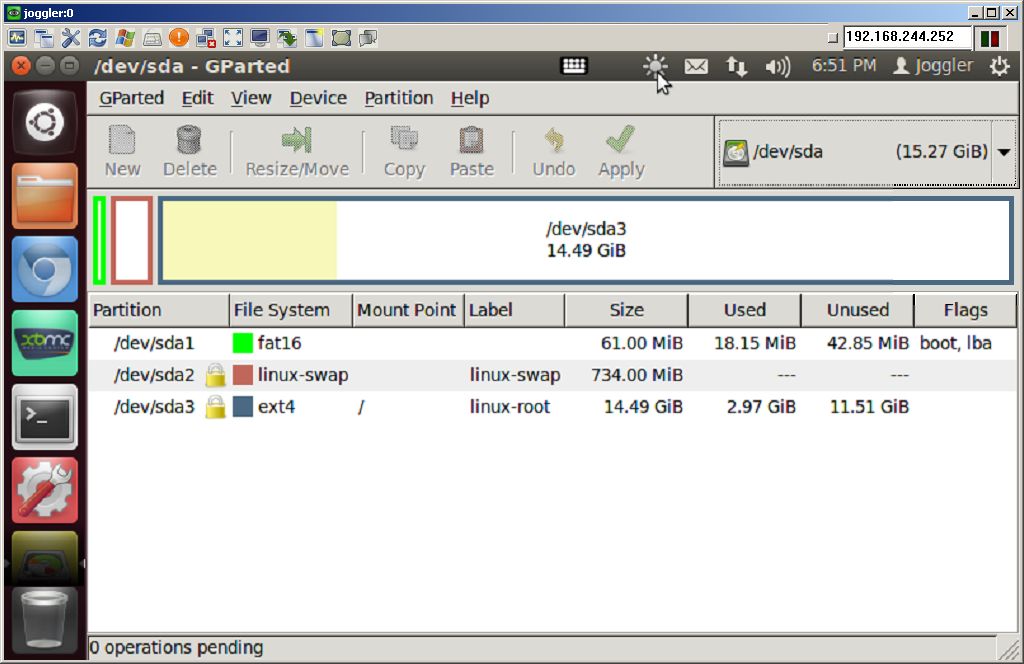

Using GParted resized the linux swap partition to double or so and the EXT4 partition to using the rest of the SSD drive.
Linux boot remains at 61 Mb, Swap (fat fingered) at 734Mb and Linux root at 14.49 Gb.

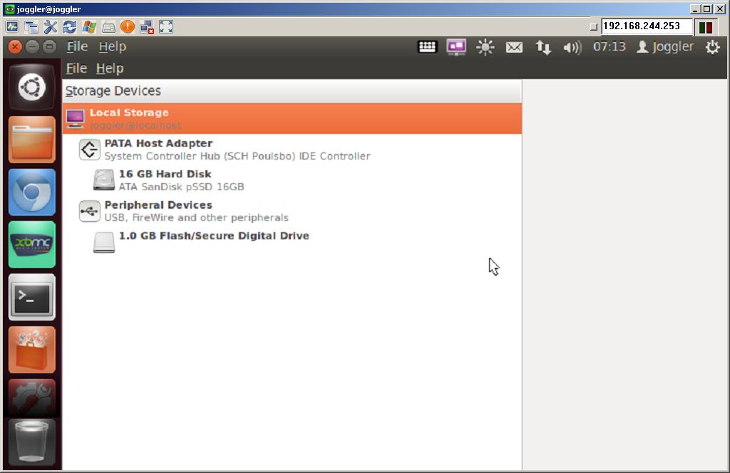

Testing first by connecting the SSD card and booting with Buzz's build. I see it just fine. No boot though right now.
root@joggler:/dev/disk# ls
by-id by-label by-path by-uuid
root@joggler:/dev/disk# cd by-id
root@joggler:/dev/disk/by-id# ls
ata-SanDisk_pSSD_16GB_ANZ062509013740 scsi-SATA_SanDisk_pSSD_16_ANZ062509013740
ata-SanDisk_pSSD_16GB_ANZ062509013740-part1 scsi-SATA_SanDisk_pSSD_16_ANZ062509013740-part1
ata-SanDisk_pSSD_16GB_ANZ062509013740-part2 scsi-SATA_SanDisk_pSSD_16_ANZ062509013740-part2
ata-SanDisk_pSSD_16GB_ANZ062509013740-part3 scsi-SATA_SanDisk_pSSD_16_ANZ062509013740-part3

I have now seen the built in realtek network interface issue; similiar to the Joggler (and related to windows) on other computers with built in cmos/clocks. (IE: an Asus computer that I put together for my sister-in-law recently). I gave up dealing with it on the PC and just disabled the internal NIC and installed a PCiE NIC card; and now its working just great.
I compounded the issue by direct wiring cloned USB 1.0 Asix chipped (looked like an Asix but wasn't). I have recently switched these over to tiny Asix 2.0 USB NICs and performance relating to networking and OS is totally way better in XP.
Re: Joggler II or Openframe 1.0 PATA SSD mod
Just a reminder here to backup stuff when playing.
I have been adding "everything" but the kitchen sink to Buzz's Ubuntu build. That and I test something then add more to the build. Doing it so fast now I forget to back up my builds (guess that is me being in a rush).
