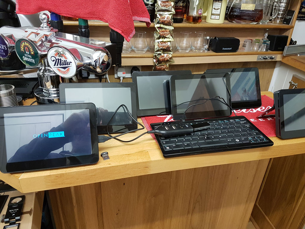

Screens
Sorry about the image quality. I had to take the pics using a camera phone.

Well I took my time but now have my reflash and PNP sticks at the ready , let the reflashing begin , I don't even know how many Jogglers I have at present ;-)
Posts: 1921
Re: PnP III v3.60 July 2017 Update
Post by hawsey » Wed Aug 02, 2017 9:15 am
Reflash first Image
Posts: 1921
Post by hawsey » Wed Aug 02, 2017 12:53 pm
My Son is 7 , looking at my line of Jogglers getting the PNP treatment he said " Dad you've got a bit of a problem there haven't you "
I think he has a point ...Image

Good, glad it’s working fine. I've never seen so many jogglers in one place before :o I only have 3 and they are all running the new PNP3
