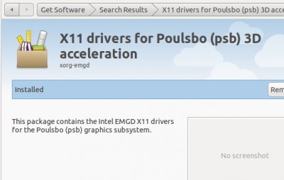

The new build shows:
root@joggler:~# lspci -k
00:00.0 Host bridge: Intel Corporation System Controller Hub (SCH Poulsbo) (rev 07)
Subsystem: Intel Corporation Device 8119
00:02.0 VGA compatible controller: Intel Corporation System Controller Hub (SCH Poulsbo) Graphics Controller (rev 07)

it won't work as there will be an xserver version mismatch. Why not just upgrade to the latest ubuntu? if you like the interface of netbook remix, you can get that working my current ubuntu natty images.
