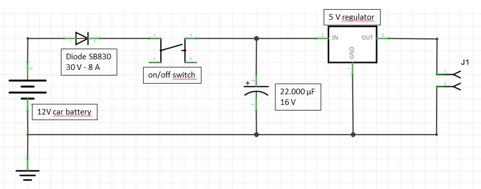

Anyway - I think I have my setup *finally* working now.
No more glitches seen on Arduino; Joggler boots fine during engine cranking on a cold morning.
It was really the 22.000µF electrolyte Cap, that did the trick! (2.000µF was not enough, higher µF 'GoldCaps' had a too high inner resistance, so couldn't deliver enough juice to the joggler )
See attatchment for my new setup.
Here are the parts:
China regulator (as before): http://www.ebay.de/itm/141814284723?_tr ... EBIDX%3AIT
Diode (so the crankmotor does not suck the cap empty): https://www.conrad.de/de/schottky-barri ... 61029.html
(30V / 8A might be overkill, but the large Cap sucks a lot of Amps while charging - even though only for a few msecs.... Since the diode is cheap - better save than sorry)
22.000µF Cap: https://www.conrad.de/de/elektrolyt-kon ... 46200.html
(Switch from scrap parts)
So, everything under 10€.
I am very happy with this - now, I am REALLY waiting for Mickchip to come back from vacation to learn more about his new build!!! :D
(Also; I saw that running the XPNav via coreboot cuts the boot time from 2 minutes to 1 minute(!), so I am really hoping that I get some version reliably to boot via corebios.....)

... and I can confirm after 3 days excercising the Joggler in the car that the above power setup works without a glitch.
Now let's see when Mickchip comes back, so we all can hopefully continue tinkering soon! :-)

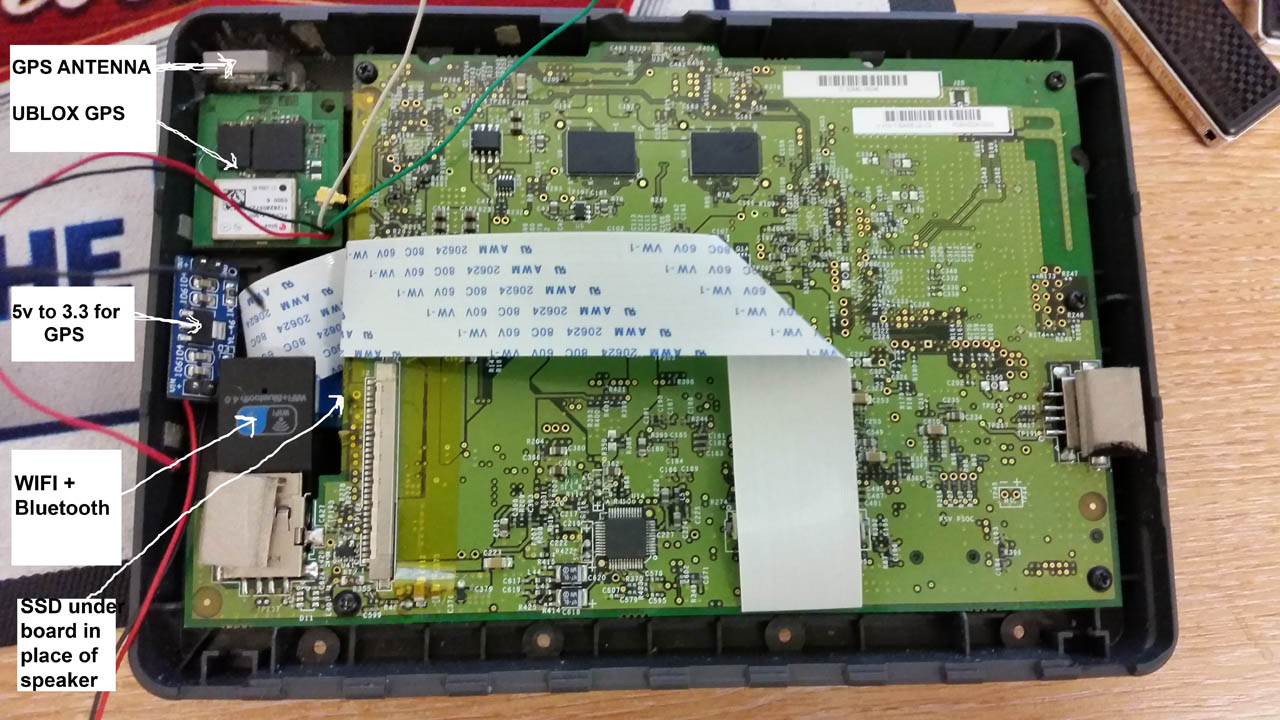

My Joggler Satnav project, not finished yet but getting there.
Had to remove one speaker to fit everything in, the SSD is under the board.
This is my betting shop joggler
The SSD 32gb
The SSD 32gb
jogglerhase
Posts: 174
Re: Satelite Navigation on the Joggler
Post by jogglerhase »
Holy sh....that is impressive, Mickchip!
Where do you get the long flat cable and thy tiny SSD?
Anyway - very nice!

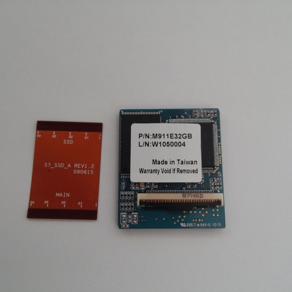

The SSD is from a Viliv X70EX but there are none available on ebay however the ones Pete uses are.
http://www.ebay.co.uk/itm/KingSpec-SSD- ... Swm8VUv6V5

The Kingspec SSD USB 2.0 drives that I use are very fast RW devices. To get them to fit inside of the Joggler I removed them from their case.
I see the Kingspec SSD USB devices on Amazon here. Note that these are true SSD devices.
https://www.amazon.com/Kingspec-Speed-S ... 0AVJ6?th=1
Early Jogglers running XP / Ubuntu here all used these Kingspec SSD USB sticks. Always worked for me; never failed.
