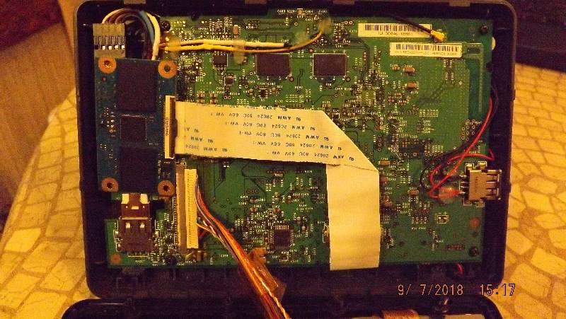

I have tried this purchasing the ZIF clips for the O2 Joggler and the Openpeak 2 (with front speakers).
Purchasing a hot air gun and tiny tips for my soldering station with large circular lamp with magnifying glass.
Totally destroyed the pads on the Openpeak 2. That said I have left it open for tinkering. Added another USB port to it using the USB camera pins, microSD socket (which did not work) and was working on looking for a tiny mini PCie true SATA card.
Here also have what appears to be an O2 prototype board that is the same as the Openpeak 2 except with a bunch of stuff removed and a socketed EFI boot chip rather than a soldered one. The motherboard is marked with red marker on both sides "O2". It boots up fine.
I had issues with the connected ZIF clip on the O2 Joggler where it remains on and I believe soldered correctly.
This was all many years ago.
I came across a batch of Openpeak 1's a few years back which look exactly like the Openpeak O2 except these have a metal heatsink that runs across the entire width of the mother board, PATA ZIF clip, Zigbee Chip, DECT chip and working microphone (for DECT chip use). These were being sold on Ebay in a trickle of sorts and coming from OpenPeak via 3rd parties. All of these were marked beta units and had an Openpeak logo O2 style on the case.
Purchased everyone of these I saw on Ebay being sold from around $35 up. I do not think most folks assumed that they were O2 Jogglers.
Modded these adding an RTC/battery, Realtek NIC ROM, PATA SSD drive and Aux USB hub. Never did add a digital audio output though.
The ZIF cable is just a flipped cable 40 or 44 pin cable. Fits nicely across the motherboard to the SSD drive. Set ups here have the WLAN stick, SSD drive and RTC on the left. I did clip out some plastic for this stuff to fit. Case closes / snaps together fine.
Today these are my base Jogglers as they each have a 16Gb SSD drive and aux USB port running embedded Windows XP from the SSD drive.
I have a few of these running Buzz's Ubuntu Linux. I did have one booting from the SSD drive. I do not know how I got this to work as I trashed it the other day and redid the whole using a USB SSD stick inside to boot to the PATA SSD drive such that I have 24 Gb of SSD drive and use the stick for the home drive.
Ideally getting the PATA port to work on the Openpeak 2 would be nice as the ZIF cable and SSD are relatively skinny enough to close the case. I did try a Broadcom Crystal mini PCIE card for being able to stream live TV on the Openpeak 2 with KODI. Worked great streaming movies, live TV and using SSD storage or a USB stick. The Openpeak 2 also has an RTC battery and Zigbee chip and DECT chip and microphone for telephony.

The old O2 is somewhere here in pieces in a plastic bag. That said took apart last modified Openpeak which shows the ZIF clip and ZIF cable. Note here the flipped ZIF I used was too thin on one side so I put some scotch tape on side and carefuly trimmed it with a razor blade for a tight fit.
I have this one defaulting to Squeezeplayer and the eMMC is starting to go as I had to wipe it a few times with Andy's boot repair and write application.
I just now removed the SSD and USB stick and it took some 5 minutes to boot. Even Squeeze player is sitting at the logo for a very long time.
Definitely an issue here with the stall of the boot and related to the eMMC. Rewrote Andy's SP OS and it ran FSCK 3 times before it started to write to the eMMC. It still is stalling when writing to the eMMC. Wondering if I should try writing a seabios to the rom then booting to a USB stick in DOS to low level format the eMMC?
Seems that it checks the eMMC first before booting the USB/SSD card and that is where it is stalling.

3 - Flipped 40 Pin ZIF cable - ~ 14 cm long and folded as in picture - blue and blue ends are thicker and work better. With a white end you need to thicken it a bit for the clip so I used scotch tape.
4 - you can fit the PATA SSD drive on the left over the USB WiFi stick just fine. I used a bit of painters masking tape.

Not easy. Tried once and messed up the pads. Second time it looked good but didn't really work well.
Purchased OpenPeak Verizon test devices (bunch) which already had the Zif clip and that is what I am using today for my touchscreens here running.
These look like O2 Jogglers except they are labeled OpenPeak and are using different motherboards with a microphone, Zigbee and DECT chips and have a metal heatsink across the entire motherboard. Mine have been on 24/5 > 5 years now powered by POE GB power and OpenPeak PS.
They are like the larger Openpeak 2 devices with the speakers in front except there is no mini pcie card slot inside. The boot EFI rom chip is replaceable on the Openpeaks.

Firstly, the right connector to solder to the Joggler's board. In the "Adding a PATA port" guide, this is marked as PATA J11 and shows a series of solder pads, marked 1 to 40. So there are 40 pins and I believe the pitch (space between) between the pins is 0.5mm. Cheapest I could find on AliExpress delivered to the UK are :
https://www.aliexpress.com/item/32848021743.html
this is currently $1.50 for 10 pieces delivered. I'm not certain that this is the right connector, but it looks very much like/identical to the connector used in the "Adding a PATA port" guide. The listing title is "10pcs FPC Connector socket FFC 0.5MM Clamshell Bottom Contact Type 4P 6P 8P 10P 12P 14P 18P 20P 22P 24P 30P 32P 36P 40P 45P". In addition to being known as ZIF, they appear to be also described as FPC and FFC connectors. I have a data sheet for this connector and it looks like it could be the right item.
Secondly is the cable. The photos Pete provided, were very helpful here as I used the code on the cable as a starting point. That is "AWM 20624 80C 60V AW-1". Some possibilities from AliExpress are :
10pcs Flexible flat cable FFC 20cm 0.5mm Pitch Isotropy A cable AWM 20624 4/6/8/10/12/14/16/18/20/30/32/40/50/60 Pin Same sides
US $4.50
https://www.aliexpress.com/item/32839515697.html

With the right connector soldered to the Joggler's board and the right cable, I believe a storage device with the 40 pin IDE PATA ZIF connector could be used directly, Alternatively, an adaptor board could be used that will take the 40 pin cable and allow a standard IDE PATA storage device to be used or a compact flash card. Or possibly other interfaces and storage devices.
With a long enough cable, it could be brought out of the Joggler's case and the storage device and possible adaptor can be held on the outside back of the Joggler, or possibly other locations.
I'd be very interested to hear comments on the above, especially if I have the parts right or not. My biggest concerns are on the pitch of the connector (0.5mm) and the type of connector. Aliexpress, has a few different types. I'm guessing that there is some sort of opening on the connector that the cable can be inserted into, and the opening then closed, so that that the contacts on the cable are pressed against the pins soldered onto the Joggler's board.

I've ordered what I believe are the right parts and hopefully they will arrive safely from distant lands. My greatest concern is obtaining the right socket to solder onto the board. Anyway, I'll find out eventually.
When looking at an Orange PI PC recently, there is a very similar/same connector, albeit less contacts, for the camera.

Somewhere here have a bunch of these zif sockets. That said will take a close up picture of the socket installed in the Openframe2. With these sockets I used a flipped ZIF cable. It was long and I folded it inside of the OpenFrame.
Will look for my box o zif sockets....thinking they are lost on my workbench...will find them...

Hi Pete,could I just solder a PATA port on joggler board and use a cable to connect it to a real ZF SSD card? Like attached pic.
16gb Sandisk ZIF SSD
Posts: 2952
Re: Solder header onto Joggler PATA port
Yes.
I have 15 of these in 15 running Windows XPe for my touchscreen automation using Seabios. Boots fine from SSD. Fits nicely with original wireless USB stick.
Soldering the ZIF clip has been documented here way long time ago.
That said they are installed in Openpeak devices which are a bit different from O2 Jogglers. The OpenPeak devices have Zigbee and DECT built in and a large metal heatsink over the CPU and motherboard. Also they have built in a ZIF clip. You need a flipped ZIF cable to use the SSDs with the ZIF clip on the motherboard. Note too that the Realtek chip on the Joggler needs to be configured with the Realtek rom editor.

Pete, I only have Joggler only. I want to solder a zif socket on joggler’s motherboard, and use zif 40 pin cable to connect this zif SSD. Below is my questions.
1, Does it work?
2, the zif cable and socket is 0.5mm size, right?
3, if I can install squeezeplayOS with this SSD installed?
4, any other work I need to do ?
5, you mentioned Realtek chip, do you mean the EF chip? Or the sound card or lab card?
Posts: 2952
1, Does it work?
Yes.
https://www.jogglerwiki.com/wiki/Adding_a_PATA_port
It is a standard 40 pin zif cable and the ends were flipped that I am using.
Yes. I have to check my Ubuntu / SSD Openpeak. Modded it with an RTC clock.
no.
The Realtek NIC chip has no MAC on it. You have to reprogram it.
