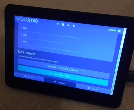

The GUI is there but a whole raft of permissions issues means it doesn't do much. I can at least add a SAMBA share (which persists through reboots). It recognises the sound device as "MID", which sounds :) about right.

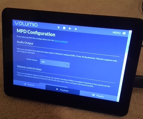

"aplay -l" lists the available devices as below:
card 0: MID [HDA Intel MID], device 0: STAC92xx Analog [STAC92xx Analog]
Subdevices: 1/1
Subdevice #0: subdevice #0
card 0: MID [HDA Intel MID], device 1: STAC92xx Digital [STAC92xx Digital]
Subdevices: 1/1
However, whatever permissions issues exist mean that MPD isn't indexing files and probably a load of other issues too. I can't add files over the network so didn't get it to play anything. Time constraints mean this little experiment has come to an end for me for the time being.

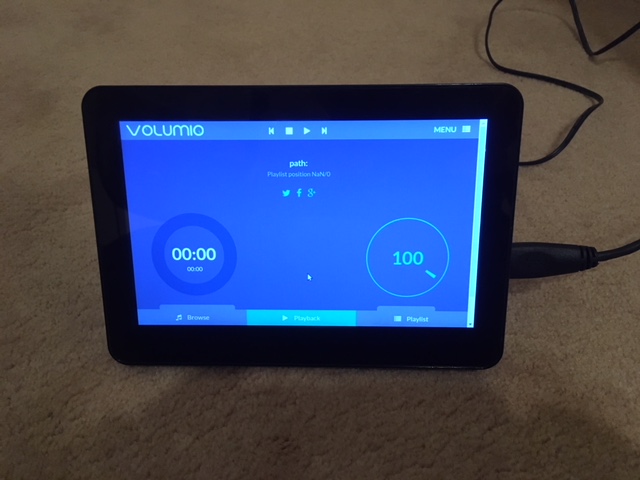

I've attached some photos of a neutered volumio at least running on the joggler. Maybe me or someone else could pick it up later. There are volumio plugins for LMS and squeezelite, but I didn't test those.

Very nice.
Apologies I was moving your pictures one post up thinking while you were doing the same thing.
I was going to suggest to start with Buzz's base Ubuntu build that'll fit on the 1Gb eMMC built in to the Joggler.
Then build base x windows and add Volumio to that?
