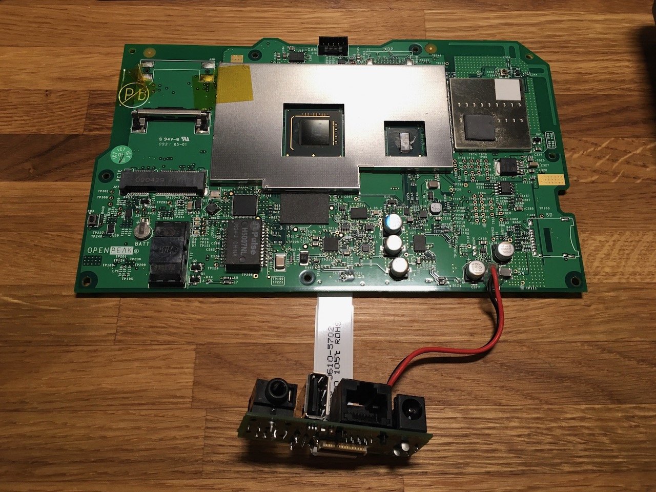

But yes, it's a real shame about acceleration. My OpenFrame 2 currently looks like this:
So I can fit a BCM70015 hardware video decoder to that little mini-PCIe slot to see if my build of Plex Media Player is of any use. It's fine for audio, but the overhead of the UI makes video pretty useless, even with server transcoding.
