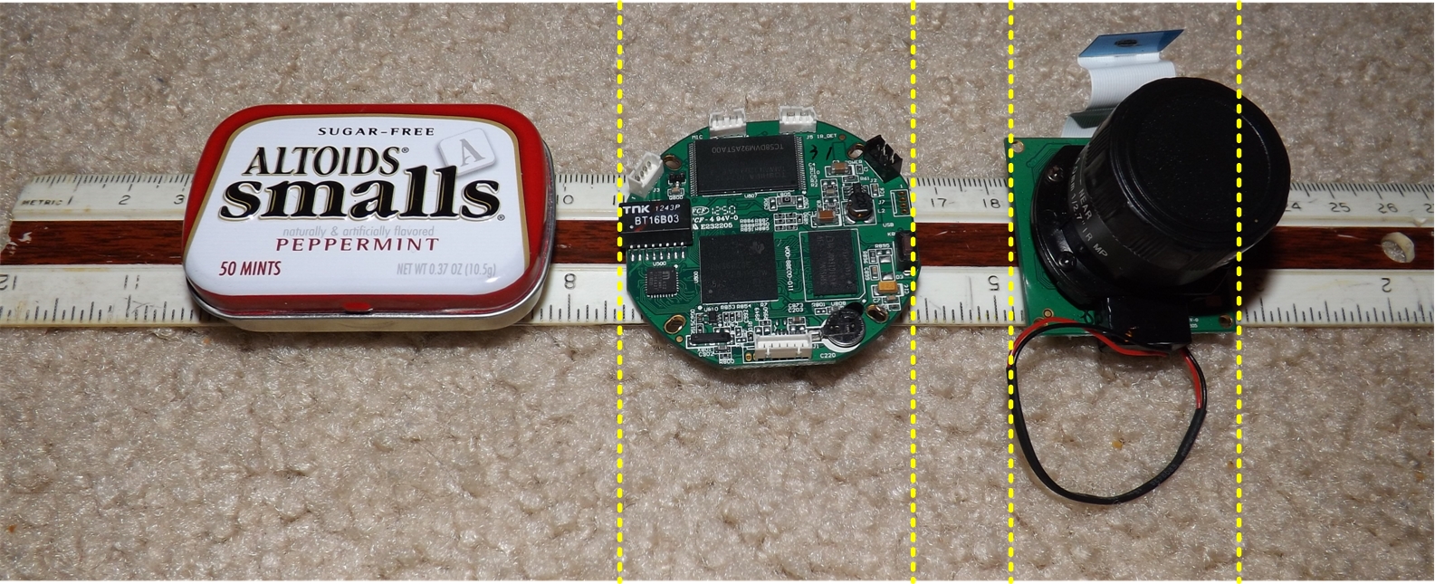

Playing with Grandstream IP HD camera SIP integration to see how it works. This might be something you would be interested in.
