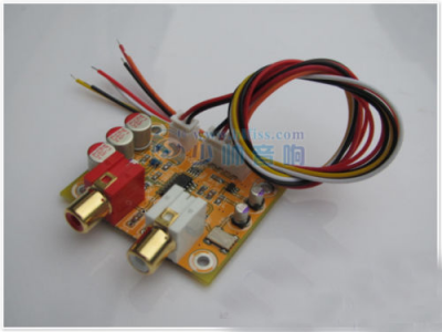

I had looked at the USB DAC boxes. Is that what you mean by hard wiring the DAC? Or just use the optical SPDIF wires - SPDIF to DAC?
Like your post above there is a bunch of these on Ebay today.
So just using the original mod of SPDIF out to this box:
Built-in high-performance phase locked loop (PLL), with extra-low JITTER digital receiver chip WM8805.
Maximum support 192KHz/24bit audio signal
Optical/coaxial optional input function
2 channels standard RCA output port
Indication for digital receiving status (LOCKED)
MINI USB power supply port

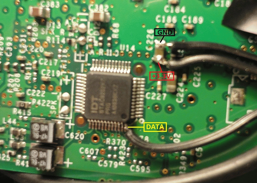

Yup; have a look here for a granular look see.
http://www.jogglerwiki.com/wiki/Internal_SPDIF_output

I can see what needs soldering on the board but it just says solder three wires to socket, but which pin goes to which part of board, maybe I'm blind but I can't see :D

It is just ground, data and 3.3VDC marked in this picture. On the optical port side here on one that I have sitting on the workbench desk there are three colors of wires. One Black (assuming that it is a ground), Red (assuming that is the 3.3VDC wire) and White (assuming that is the data wire). This is a best guess as I am not looking at the schematic or drawing of the pin outs (I do have them some place here).
