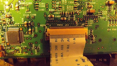

I have tried this purchasing the ZIF clips for the O2 Joggler and the Openpeak 2 (with front speakers).
Purchasing a hot air gun and tiny tips for my soldering station with large circular lamp with magnifying glass.
Totally destroyed the pads on the Openpeak 2. That said I have left it open for tinkering. Added another USB port to it using the USB camera pins, microSD socket (which did not work) and was working on looking for a tiny mini PCie true SATA card.
Here also have what appears to be an O2 prototype board that is the same as the Openpeak 2 except with a bunch of stuff removed and a socketed EFI boot chip rather than a soldered one. The motherboard is marked with red marker on both sides "O2". It boots up fine.
I had issues with the connected ZIF clip on the O2 Joggler where it remains on and I believe soldered correctly.

The ZIF cable is just a flipped cable 40 or 44 pin cable. Fits nicely across the motherboard to the SSD drive. Set ups here have the WLAN stick, SSD drive and RTC on the left. I did clip out some plastic for this stuff to fit. Case closes / snaps together fine.

Ideally getting the PATA port to work on the Openpeak 2 would be nice as the ZIF cable and SSD are relatively skinny enough to close the case. I did try a Broadcom Crystal mini PCIE card for being able to stream live TV on the Openpeak 2 with KODI. Worked great streaming movies, live TV and using SSD storage or a USB stick. The Openpeak 2 also has an RTC battery and Zigbee chip and DECT chip and microphone for telephony.

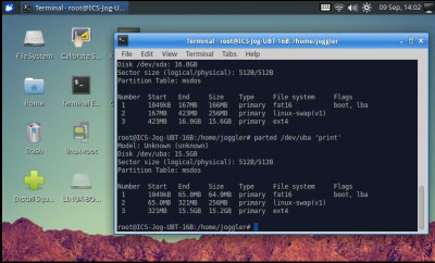

Before I started to change stuff here I was able to boot from only the ZIF SSD drive. I did redo the USB stick and the SSD drive was booting form the USB stick.
What I did though is change the name of the boot partition to all capital letters and the grub.cfg and fstab were showing the partitions in lower case.
(fat fingered the naming of the partitions)
Changed the grub.cfg and fstab such that the Joggler now boots from the SSD rather than use the USB to boot.
Now changing the USB stick such that it just becomes a home drive disk when booting.
Now internal to the Joggler have 32Gb of play space and went to using a nano USB wifi stick for wifi which works fine.

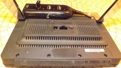

Another option is the addition of a small USB hub to the back of the Joggler using the motherboard pins for USB 2.0 as documented on the Joggler Wiki.

Basically here just wrote Buzz's Ubuntu latest desktop image to a PATA SSD ZIF drive using a small ZIF to mini USB card.
Expanded the image to the size of the SSD.
Used GParted to rename the partitions to linux-boots, linux-swap2 and linux-roots
Edited the /boot/grub.cfg file like so:
loadfont /unicode.pf2
terminal_output gfxterm
set timeout=5
menuentry "Xubuntu 14.04 LTS (Trusty) - 3.2.84joggler1" {
linux /vmlinuz-3.2.84joggler1 root=LABEL=linux-roots ro quiet splash
initrd /initrd.img-3.2.84joggler1
Edit the /etc/fstab file like so:
# /etc/fstab: static file system information.
# Use 'blkid -o value -s UUID' to print the universally unique identifier
# for a device; this may be used with UUID= as a more robust way to name
# devices that works even if disks are added and removed. See fstab(5).
# <file system> <mount point> <type> <options> <dump> <pass>
proc /proc proc nodev,noexec,nosuid 0 0
LABEL=linux-roots / ext4 errors=remount-ro,noatime 0 1
LABEL=LINUX-BOOTS /boot vfat defaults 0 0
LABEL=linux-swaps none swap sw 0 0
tmpfs /tmp tmpfs defaults 0 0
You can keep the entire working partition to the PATA SSD card. Here used a 16Gb USB stick for my /home directory stuff. Easy to do this by:
1 - create a new ext4 partition on the USB stick using Gparted from the Joggler Ubuntu desktop
2 - mount a new home directory locally on the SSD IE: say /media/home
3 - rsync /home to /media/home IE: sudo rsync -aXS --exclude='/*/.gvfs' /home/. /media/home/.
4 - edit your /etc/fstab file to include or use the new home partition
IE: /dev/uba3 /home ext4 defaults 0 2

4 - you can fit the PATA SSD drive on the left over the USB WiFi stick just fine. I used a bit of painters masking tape.
One other issue that I have seen in the last few years is that the barrel connector / NIC / Audio board ports sink in to the Joggler. This can cause an intermittent power connection to the Joggler. This is because the board is mounted with hot melt glue. The easy fix is just to heat up the glue until it melts a bit while holding the board in place. To get to the combo board you have to remove or move the motherboard over a bit. I used a BBQ grill gas lighter with a stalk to heat up the hot melt glue just for a few seconds such that I do not melt the plastic around the board.

It is sugggested to also write a new ROM to the Realtek built in NIC. Doing so will let you suspend and use a WOL to wake up the Joggler with a magic packet and have a MAC address as the original rom on any model Joggler doesn't have a MAC address.
Optional too is the installation of an RTC with battery. Note that the Openpeak 2 already has a battery in it.
Just a bit of bit banging and loading up the RTC on boot.
And still another hardware option is the installation of an optical HD audio port fitted to the back of the Joggler. This too is documented in the Wiki.
I have not played much lately with the Joggler hardware as it has been working just fine these days.
set timeout=5
Hardware required:
1 - ZIF clip
2 - USB to ZIF drive case with USB to ZIF board
3 - Flipped 40 Pin ZIF cable - ~ 14 cm long and folded as in picture - blue and blue ends are thicker and work better. With a white end you need to thicken it a bit for the clip so I used scotch tape.

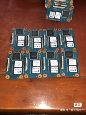

Hi Pete,could I just solder a PATA port on joggler board and use a cable to connect it to a real ZF SSD card? Like attached pic.pete wrote: ↑Fri Aug 16, 2019 11:03 pm Somewhere here have a bunch of these zif sockets. That said will take a close up picture of the socket installed in the Openframe2. With these sockets I used a flipped ZIF cable. It was long and I folded it inside of the OpenFrame.
Will look for my box o zif sockets....thinking they are lost on my workbench...will find them...
Re: Solder header onto Joggler PATA port
Yes.
I have 15 of these in 15 running Windows XPe for my touchscreen automation using Seabios. Boots fine from SSD. Fits nicely with original wireless USB stick.
Soldering the ZIF clip has been documented here way long time ago.
That said they are installed in Openpeak devices which are a bit different from O2 Jogglers. The OpenPeak devices have Zigbee and DECT built in and a large metal heatsink over the CPU and motherboard. Also they have built in a ZIF clip. You need a flipped ZIF cable to use the SSDs with the ZIF clip on the motherboard. Note too that the Realtek chip on the Joggler needs to be configured with the Realtek rom editor.
The OpenPeak devices were sold as DECT / VOIP tabletop devices or Thermostat / Energy management devices way long time ago.
BTW here run Squeezeplayer on Windows XPe Jogglers and Linux Jogglers.
Yes.
Pete, I only have Joggler only. I want to solder a zif socket on joggler’s motherboard, and use zif 40 pin cable to connect this zif SSD. Below is my questions.pete wrote: ↑Wed Apr 06, 2022 11:57 am could I just solder a PATA port on joggler board and use a cable to connect it to a real ZF SSD card?
Yes.
1, Does it work?
2, the zif cable and socket is 0.5mm size, right?
3, if I can install squeezeplayOS with this SSD installed?
1, Does it work?
Yes.
https://www.jogglerwiki.com/wiki/Adding_a_PATA_port
It is a standard 40 pin zif cable and the ends were flipped that I am using.
Yes. I have to check my Ubuntu / SSD Openpeak. Modded it with an RTC clock.
4, any other work I need to do ?
no.
5, you mentioned Realtek chip, do you mean the EF chip? Or the sound card or lab card?
The Realtek NIC chip has no MAC on it. You have to reprogram it.
