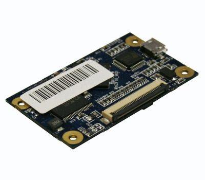

The oldest O2 Jogglers here all had a second internal USB port. I soldered wires from the motherboard to a miniUSB cable and added a second external USB port on the back of the Joggler (for use with whatever). Eventually though migrated to using the ZIF pata port from this methodology.
I went to booting using that port and a USB to ZIF card plus ZIF SSD which fit fine where the wireless USB stick was. I taped the ZIF USB card to the ZIF SSD card and they fit fine where the original USB WLAN card was. Over time (> 1 year) the mini USB port has fallen off the ZIF to USB card on about 3 of these devices. I have seen the same thing happen with other hardware with mini USB ports on it (IE: test GPS for example).
I then took the internal USB port out for either a wireless NIC or wired NIC.
That also worked fine. Here I have one with that setup plus an audio USB output.
I have tested with those little tiny USB sticks and larger ones with antennas and they worked fine. (Asus)
http://www.asus.com/us/Networking/USBAC51/
http://www.asus.com/us/Networking/USBAC56/
USB to ZIF card
16Gb ZIF card

Posts: 2936
Re: Best USB stick for Joggler?
Speedwise from slower to faster was:
1 - Kingspec USB SSD (have to remove the casing to use it in the Joggler).
2 - USB to USB-ZIF to ZIF SSD (here I have lost 3 of these due to heat making the mini USB port fall off).
3 - PATA ZIF connected SSD
The Kingspec SSD is sort of big such that I had to remove it from the casing to fit inside of the Joggler. I only have lost one of the Kingspec USB SSDs since initial purchase (> 10 purchased).
I have too lost one ZIF SSD to day (>10 purchased).
Goofing a bit with Buzz's Linux build I have today one USB 8Gb SSD and a PATA ZIF 16Gb SSD in one Joggler and both run fine together.
Just noticed the above SSD ZIF has a mini USB port on it. I have never seen one like this before. The ZIF SSD drives that I have just have the ZIF connector on them. (I was in a rush and just did a quickie google image search earlier)
There is a lot of room there (where the WLAN stick was) on that side of the Joggler. I did trim a bit of the plastic underneath the original USB wireless stick for more room for more stuff.
