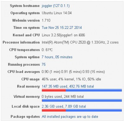

I can remove Webmin to make it a bit smaller. Attached is a picture from Webmin. It is a bit larger than OP one. I was able to fit that one on the 2 Gb MMC of the Openpeak 7e. I installed the LIRC drivers / stuff and it works fine with the Microsoft Media remote control and IR sensor. Its fast and touch works fine. There was a Joggler based Metro looking theme but it was for the previous version of XBMC. Updating to current stuff is easy using Webmin. Today will test out the Joggler Wireless USB stick functionality.

Started from scratch again. I would like to keep it to mostly BuZz's stock base build if possible.
1 - writing BuZz's base 14.04 build to an 8 Gb stick
2 - expanding build to 8 Gb initially (will shrink it for downloading afterwards)
3 - Expanded EFI boot partition some 50Mb. I get an error but it works still. Need to revisit this though.
Expanded it to a bit over 100Mb. Errors though. Went to disk manager and redefined it as an EFI boot partition; still getting errors though but boots.
4 - Installation of Webmin - just an alternative to using SSH and GUI.
5 - updating - 79 updates
6 - installation of a lite GUI (there are a few to choose from) - optional? suggestions?
Here looking at the LXDE (which is sort of what XBMC-Buntu uses), XFCE4 which is what Xubuntu uses. Open here for suggestions.
Decided to try a no GUI version first just booting into XBMC for a smaller build.
Adds list:
- Webmin
- XBMC - will leave it as is unless somebody suggests some tweaks to it.
25th November 2014
OK got it installed with no GUI. Boots fine right into XBMC. Got the little XBMC logo showing when booting.
I still see a bit of text when first booting, goes to the XBMC logo for a bit, blanks for a few seconds then to XBMC.
Ideally making all of the text see for a bit black might make it look a bit cleaner when booting.
Lost the exit menu context other than Exit (which just reboots it).
