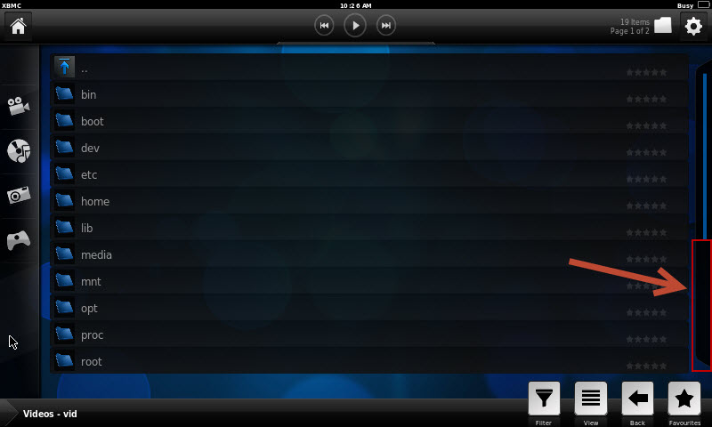

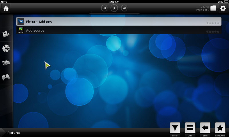

My previous post was perhaps a bit light on details, so I got vnc running to take some screenshots.

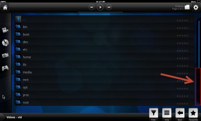

First thing i noticed is that in a list like this
You can scroll in VNC with mouse, however not with the finger on the screen

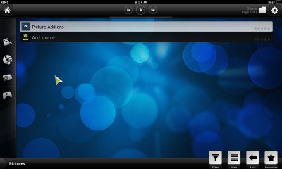

So I noticed in video page, that there is no "add source" button
However in music there is

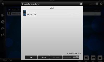

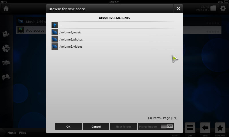

When I browser NFS, i can see my NAS, and then I can see my shared folders, however when I click on one...
Same with SMB

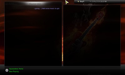

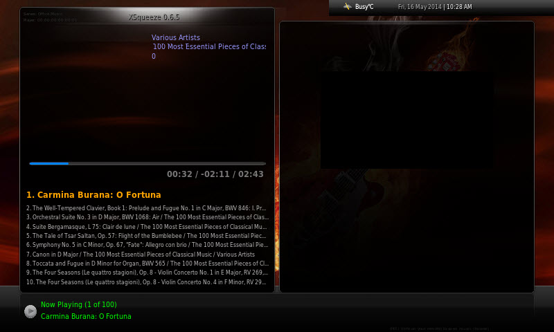

I also tried xSqueeze
When it loads (I have chosen my LMS) I see nothing, and no way to get out of the screen (in VNC you can right click, however on device no way out I can find)
I went to my LMS and could find the player listed, so it definitely connects, and when I use the LMC to play to the player, that works, although the screen is not great.
Re: [RELEASE] XBMC for O2 Joggler
@wcndave
This image is out of date which might be why some bits aren't working? Have you tried updating it? I can't help with video sharing as I don't use xbmc that way - somebody else will, I'm sure, give you tips. I use it as a tiny tv/radio/music player in my cooking corner and it works well.
The version of xsqueeze that you seem to be using is also out of date. I use a more recent version of it almost every day. It easily finds LMS which I have running on a different joggler using squeezeplay OS. It can be controlled via touchscreen (which, if I remember correctly, has to be enabled in the settings?) and can be switched off by clicking the cross in the top right hand corner. However, I find it's best controlled via the squeezebox controller app on my phone rather than via touch or mouse.
